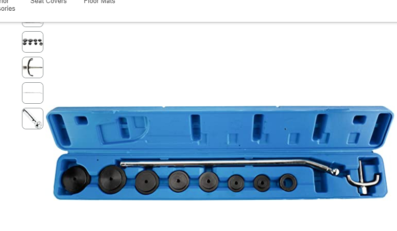

This depends on which one you are talking about, you may need to lift the engine on one side and use a long extension to knock the freeze plug inward and then use large pair of pliers to remove the old soft plug, this tool is used to reinstall the new freeze plug.
https://amzn.to/3J3iNaH
Check out the images (below). Let us know what happens and please upload pictures or videos of the problem.
