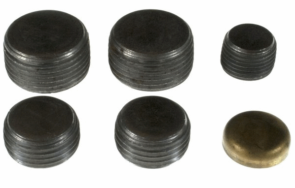

Freeze jumped need to know what size I need to fix it.
Jun 12, 2018 at 3:51 AM
STEVE W.
  • 15,350 POSTS
If you are saying that a freeze plug failed the size depends on which one it is. There are multiple sizes as well as threaded plugs and simple cups. 3/4 inch, 1.5 inch, 29/64" and 53/64 inch. If it failed due to corrosion then I would likely replace all of them as the rest are probably in no better condition.
