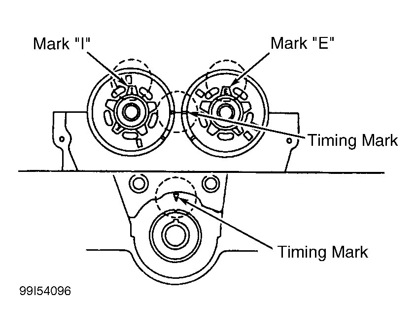

i need timimg diagram that i can view off line

I've added the image of the timing marks but the description section is something you should have in front of you as it covers installation and the adjustments for the tensioner and crank sensor. That is a bunch of pages though.
