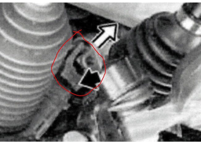

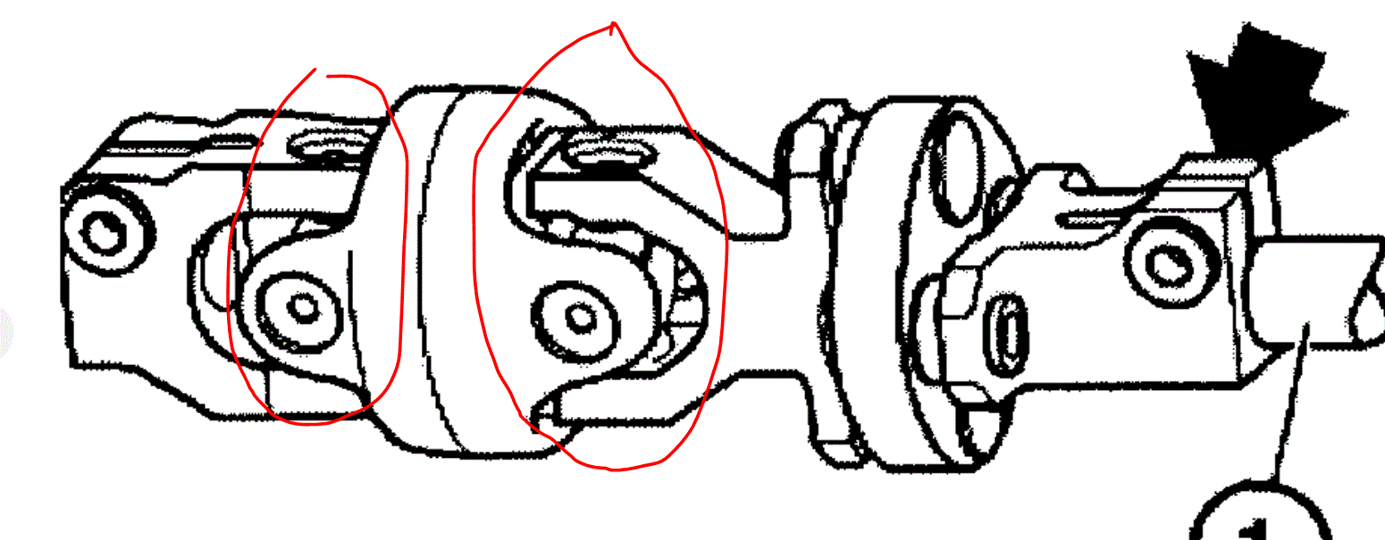

Am very familiar with these BMW's E46, and usually if there is a free play in the steering it's the lower control arm. But this car has new tires, no play in 3/6 or 6/12 and arms look good. There is play while steering is locked that i know shouldn't be there based on many i bought and sold. Can you tell or have you seen anything similar in the past?

Have you checked tie rods? Also, at 215,000 there could be play in the rack and pinion itself. Also, have you checked the steering shaft coupler? One other thing to check is the double joint as the lower portion of the steering shaft. It can have excessive wear. See pictures 1 and 2.
Let me know what you find.

Tie rods okay, not common to see rack play on these. i probably sold over 200 of them never ever had such issue. Coupler sounds about right. Am going to check it tomorrow . That is what you mean when you said one other thing, isn't it? The coupler is basically two joints together as I understand it.

Yes, that is correct. I have seen them wear and create play in the steering.

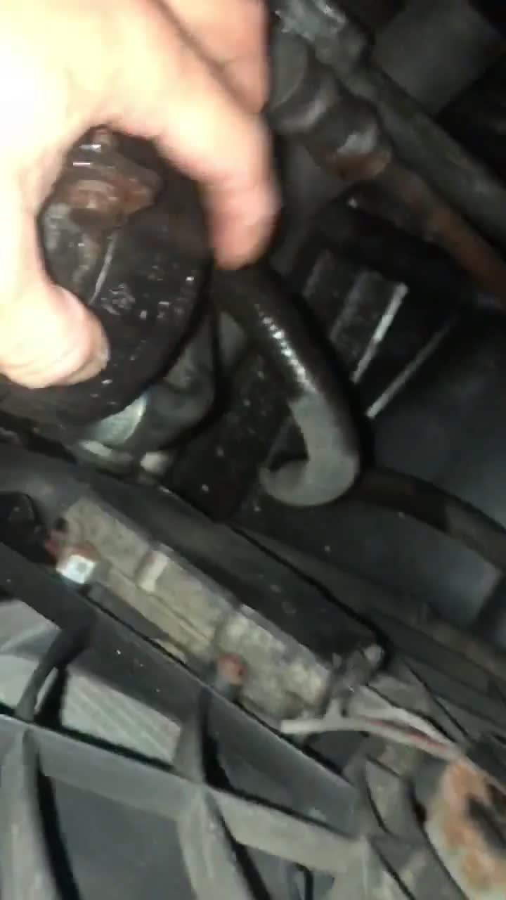

I am desperate for help, and I cannot verify my e-mail so I can place a question on the website since I have not yet to receive a verification mail from the website.

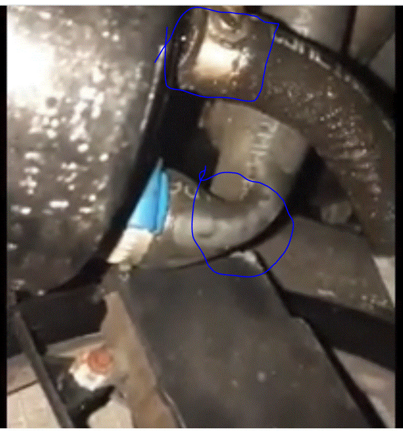

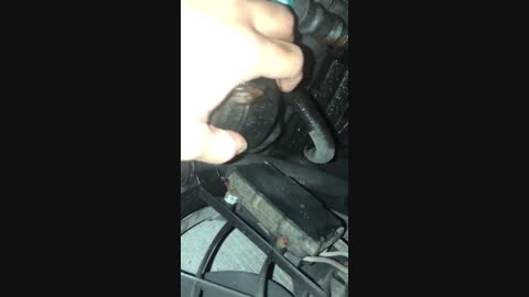

I just replaced my Power Steering Pump for my BMW e46 i318 because I began to hear a whining noise from the old one when I was turning on the car and when turning the steering wheel. I successfully replaced the old with a new one, but there is still a whining noise when I turn my steering wheel. I have also checked the Power Steering Fluid, and there is the right amount in the reservoir.
I then took a look at the hose, and by the looks of it, is it possible to assume that the hose is causing a clog?

I watched your video. Yes, it is very possible that you have a hose issue. I circled both hoses in the attached pic. The dry hose seems to have a kink in the bend which will cause an issue The second circle is just indicating a leak.
Is that what you are referring to?

That's exactly what I was referring to. How do I fix the kink? And how do I also fix the leak on the second circle?

The kink is an issue. The hoses should be form-fitted and moulded to make the turn. Is this something you have replaced or someone other has done? The only choice is to move the mount so it prevents the hose from kinking. Or, you may need to see if you can get a hose that has that bend built into it.
Now for the leak, make sure the hose clamp is tight. Also, make sure there are no tears or damage to the present hose.
Jan 16, 2021 at 4:39 AM

I have good news! I fixed the problem! The hose was bended/kinked so much that the oil in the lines could not get to the pump. So I moved the hose a bit and the noise was gone! Thank you so much for the help!
