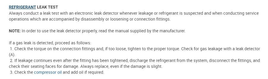

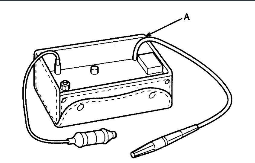

My air conditioner no longer gets cold . The previous owner said it had a leak. how can I check and fix the leak?
Feb 10, 2020 at 12:24 AM
Experienced Mechanic
52,796 POSTS
Good afternoon,
You will need to add some Freon to the system and use a leak detector to determine the leak location.
https://www.2carpros.com/articles/air-conditioner-leak-detection
