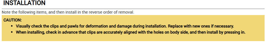

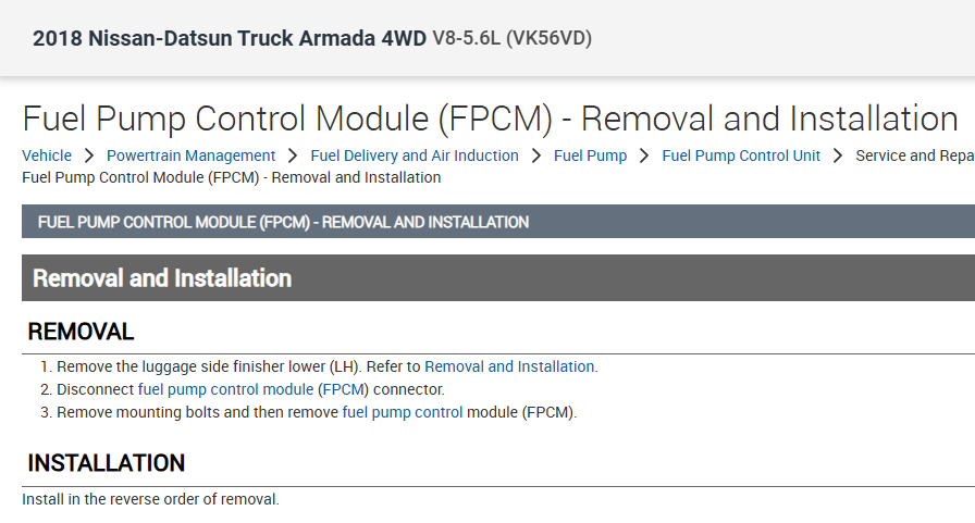

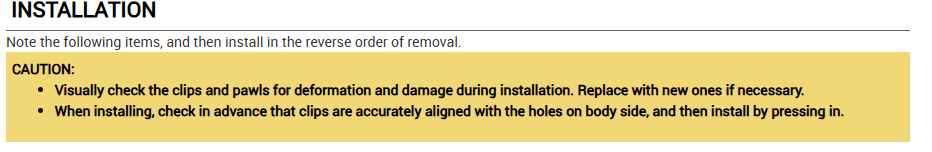

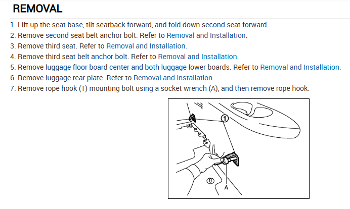

I have replaced the two fuel pumps because that was the dealer diagnosis, however the vehicle is still very sluggish. So I purchased the FPCM and want to replace it, but I can't find the location on the vehicle. I can not find anything about it online or on YouTube videos. Please help!
Sep 1, 2025 at 6:29 PM
  • 110,194 POSTS

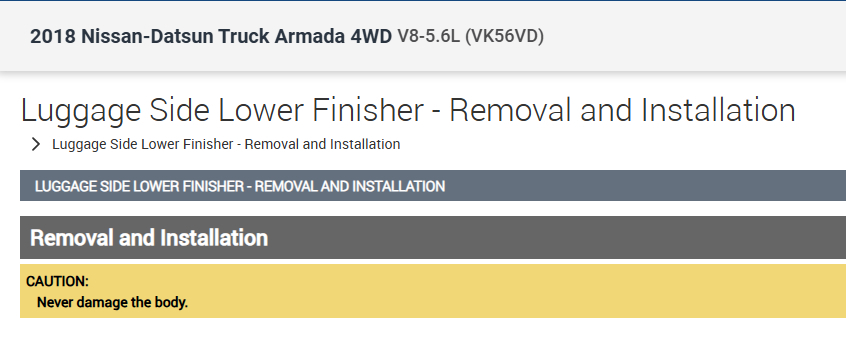

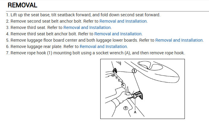

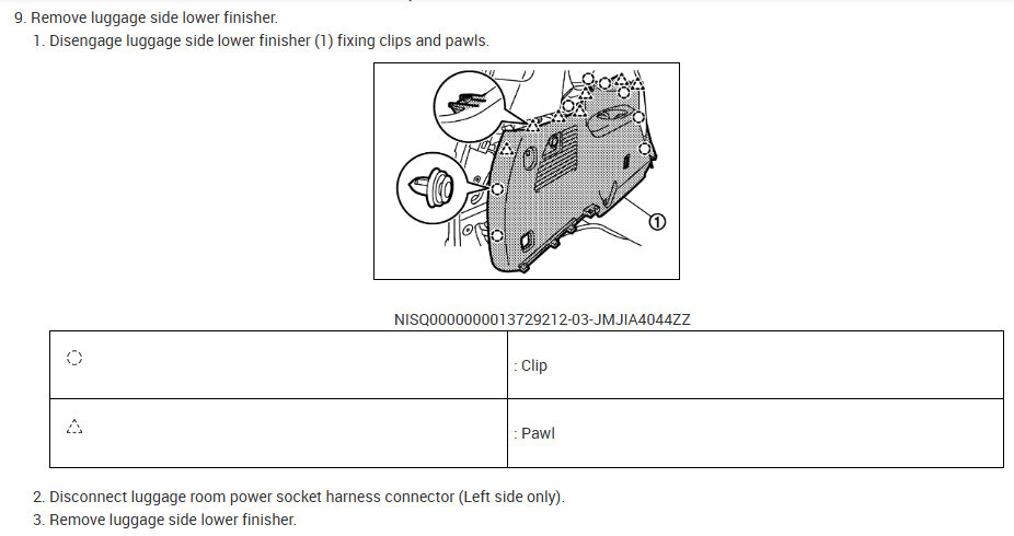

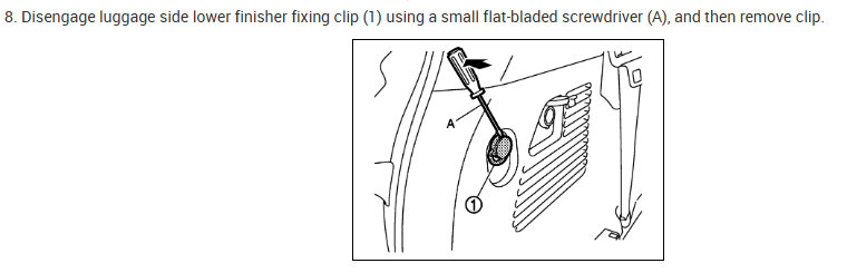

The FPCM is located behind the trim panel at the left rear (driver's side) of the vehicle. Below, I attached the directions for removing the panel first. The FPCM is located behind it. I tried to find a pic of the module, but was unable.
Take a look at the directions and let us know if you have questions or if we can help you further. I hope this helps.
See pics below. Note: The last pic is what I get when I try to find the directions. The highlighted areas should take me to specific points, but they loop me back to where I started. LOL
