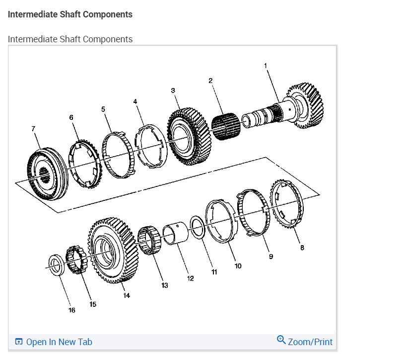

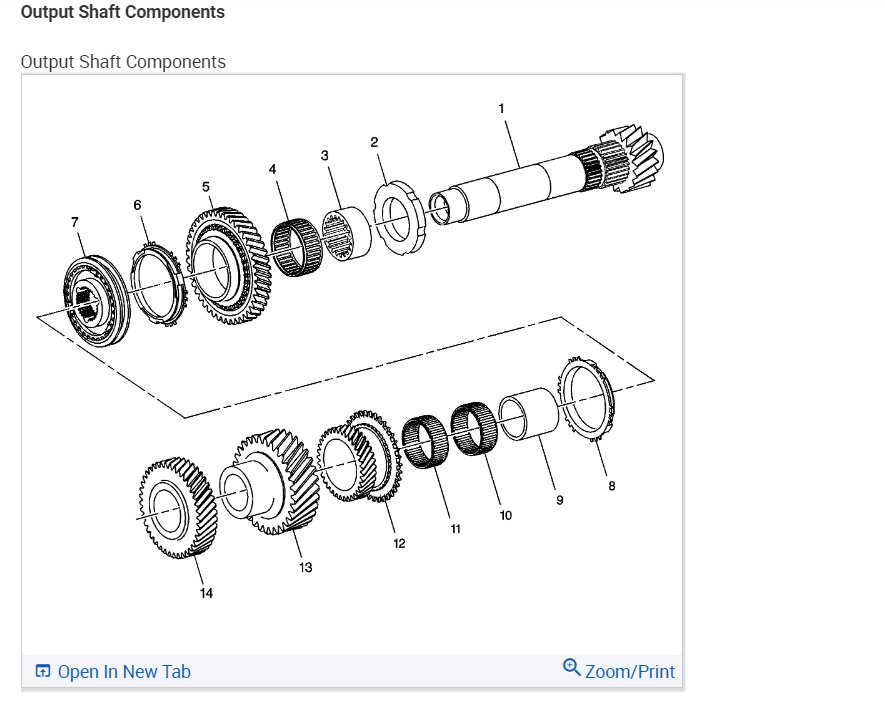

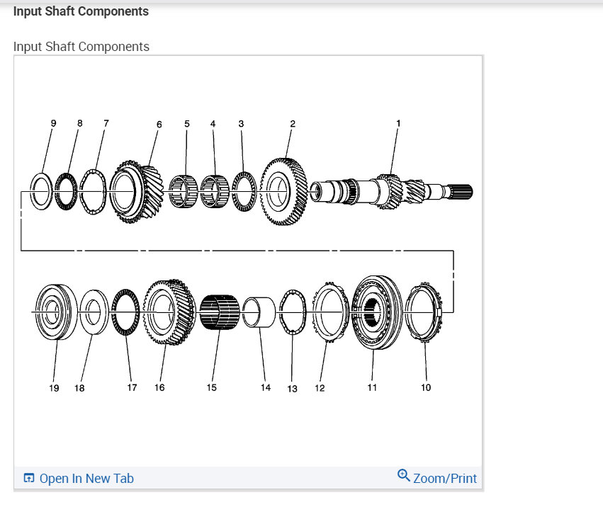

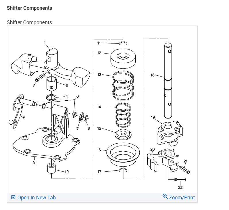

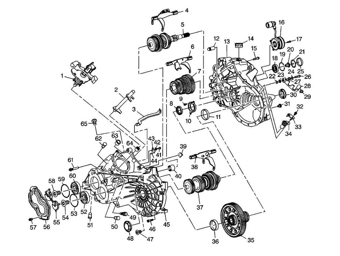

I am replacing my slave cylinder and figured I check to see if I needed to replace the fourth gear since I haven’t been to get into fourth gear. It just keeps grinding but after three or four times if I get it a certain angle it will catch, but I know one night I was trying to get it in fourth gear when I heard a loud noise and it felt like I may have chipped a tooth or more on that gear. If you can help me how to get to the fourth gear if that's what I need to replace or I was told the synchro something?
May 5, 2023 at 11:50 PM
  • 55,433 POSTS

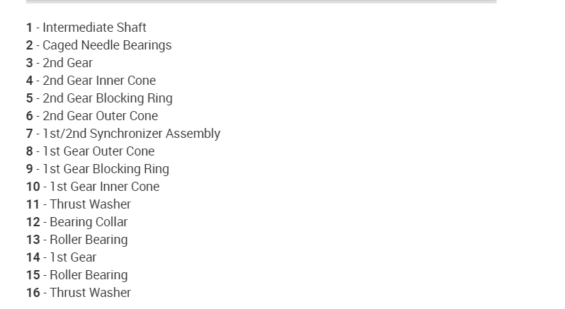

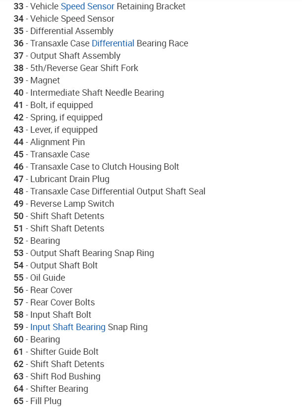

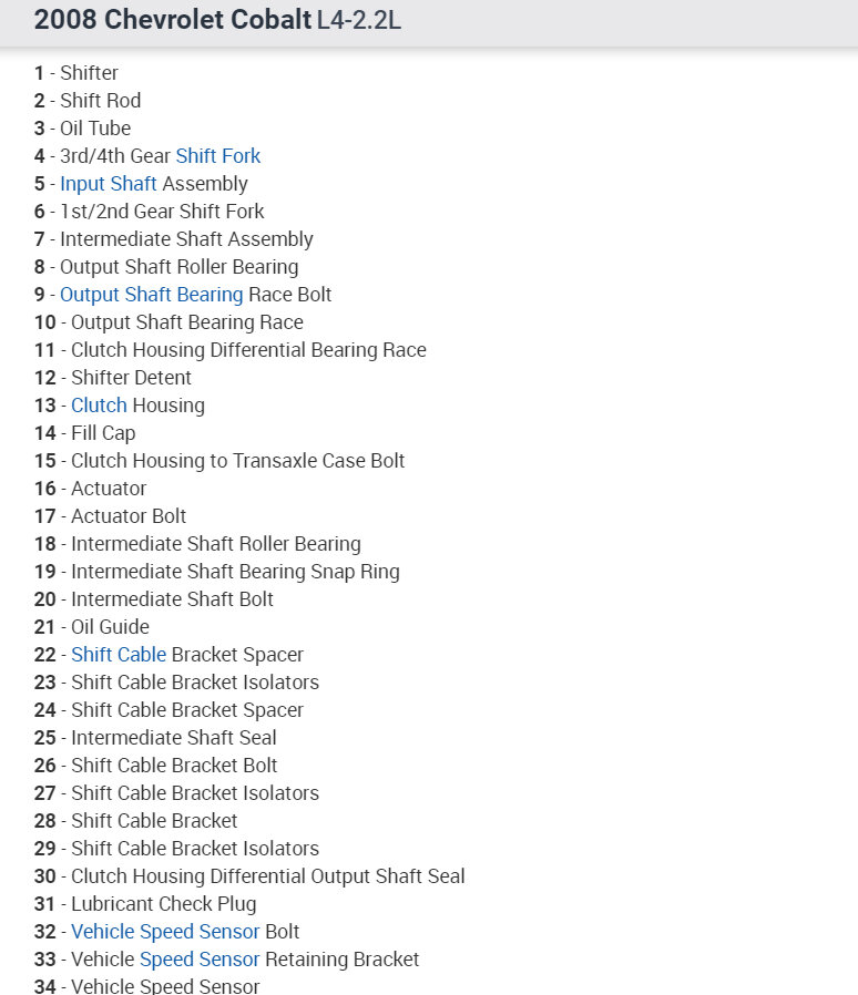

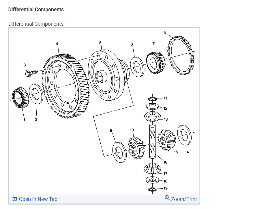

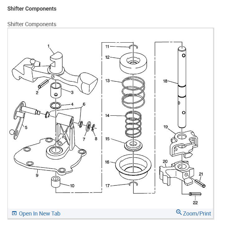

Sure, here is a video that shows how to get the transmission out and I have included the transmission rebuild diagrams in the images below:
https://youtu.be/6N6b5F2ChyE
May 6, 2023 at 5:14 AM
