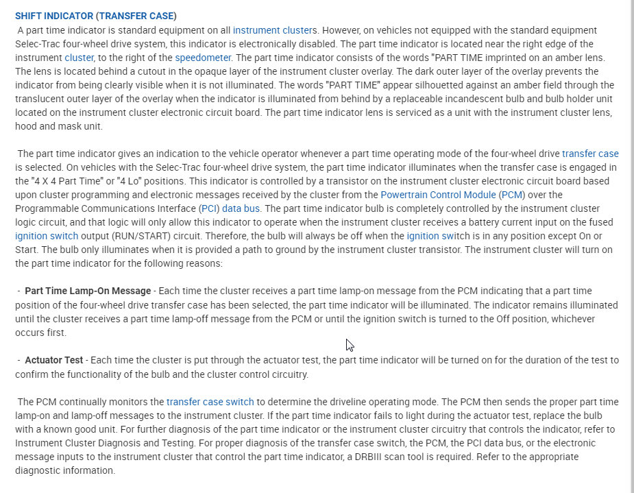

The switch on the transfer case that controls your four wheel drive to kick in on the front end what it is called. This vehicle isn’t called the quadratic either.
Dec 7, 2019 at 4:51 AM
Do you know which transfer case you have? There are three options, see attached. If you are not sure, you can send me the last 8 of your VIN and I can look it up.
Let me know and we can go from there because depending on which one, the answer is different. Thanks
