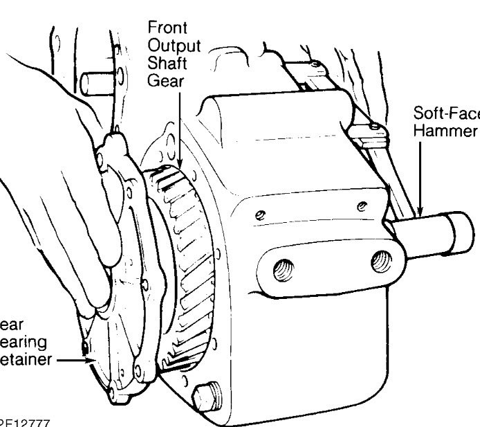

How do I get the gears out of the transfer case for the four wheel drive.

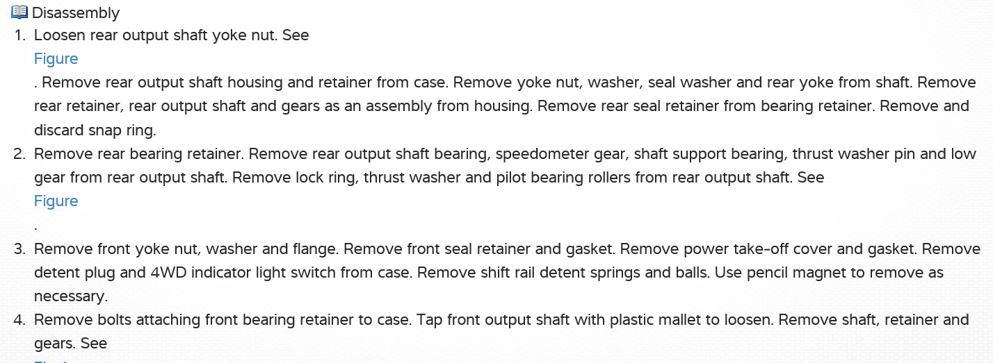

there are 4 different tcases which do you have? here is instructions on one of them others may be similar. of course the tcase needs to be out of truck

I can't read the picture

it's a jpg did you click on it? that is all we can send
