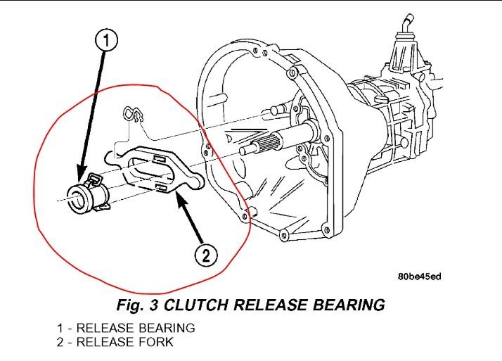

Replacing clutch and fly wheel. Clutch set arrived without a fork or center bearing. Wondering if my car actually needs a fork or center bearing because I believe it is an hydraulic clutch assembly. Can you confirm?

Yes, it is still needed even though it actuates hydraulically via the slave cylinder. I attached a picture for you to look at. Are these the parts you are referring to?
Let me know. Also, if you need directions, let me know.
