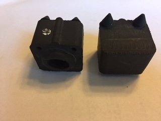

forgot to reinstalled two rubber parts
2003 PONTIAC MONTANA
74,000 MILES
XJSHEN
  • 251 POSTS
I replaced radiator on car and all A/C system worked good. But I forgot to install two tetragonal rubber bodies (image attached) after replacement of radiator and battery. I do not remember where it was located. If you could instruct me where it should be installed very appreciated.
Thanks for your help!

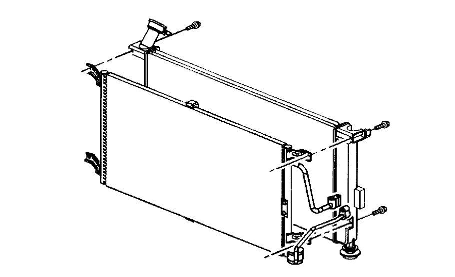

Good evening.
They are rubber bumpers or insulators at the bottom studs of the radiator and condenser. I attached a picture with the location of the insulators.
Apr 20, 2018 at 11:58 AM

Is it possible add to original place without disconnecting radiator and condenser?
Jul 12, 2019 at 12:00 AM
Yes, you just need to release it enough to lift it up and install the rubbers.
Jul 12, 2019 at 12:13 AM

But I still can’t find exact location for the rubber blocks. Is it located bottom of both side left and right or just locate both in right side?
Jul 12, 2019 at 7:57 PM
One on each side as in the diagram I posted for you.
Jul 12, 2019 at 9:32 PM

But I could not find a perfect positions for them. On the radiator or condenser? There are only two rubbers on the bottom of condenser that matched on the frame of holes on both side.
Jul 15, 2019 at 4:53 AM
Can you post some pictures for me to see what you see?
Jul 15, 2019 at 5:33 AM

Thanks experts for your kind instruction. In fact these rubber blocks are spacer between condenser and radiator at middle top and beneath of condenser and radiator on Pontiac Montana. Cheers!
