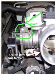

At the throttle body, there is a cam lever that the cable attaches to.
This may help as far as what the throttle bore looks like.
https://www.2carpros.com/how_to/how_to_tune_up.htm

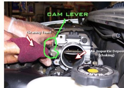

SERVICE WRITER
  • 9,123 POSTS
In this picture, this is the cam lever I mean. When the engine is running, you should be able to mobe this lever just like the hand in the picture is doing and the idle should go up.
https://images.2carpros.com/forum/automotive_pictures/30961_cabl2_1.jpg
The cable is attached to this lever. The cable runs down to the accelerator pedal.
https://images.2carpros.com/forum/automotive_pictures/30961_cabl1_1.jpg
This picture shows the end of the cable where it is attached. So when you press on the gas pedal, you should see the cam lever (not the correct name), be moved, thus opening the throttle.
Jan 28, 2007 at 4:01 AM
SERVICE WRITER
  • 9,123 POSTS
https://images.2carpros.com/forum/automotive_pictures/30961_cabl3_1.jpg
When the throttle plate opens, it allow more air into the engine. This picture shows the plate opened in the bore. The cable moves the lever, the lever moves the plate and the engine increases in idle.

Thanks for all your help, guys.
The cables had slipped out of some kind of bracket.
Put back in. Worked.
In the meantime, it was towed. Cost me $265.00!
But, you guys helped.
So, thanks.
Rene

RENE
  • 8 POSTS
Towing....
long story.
Not anyone's fault here.
In fact, the reason it got fixed was the pictures you posted and I printed to show the friend/mechanic.
He knew what to look for, found the problem and bingo. Put it back in bracket slot, and the gas pedal worked again!
So, thanks again.
Rene
