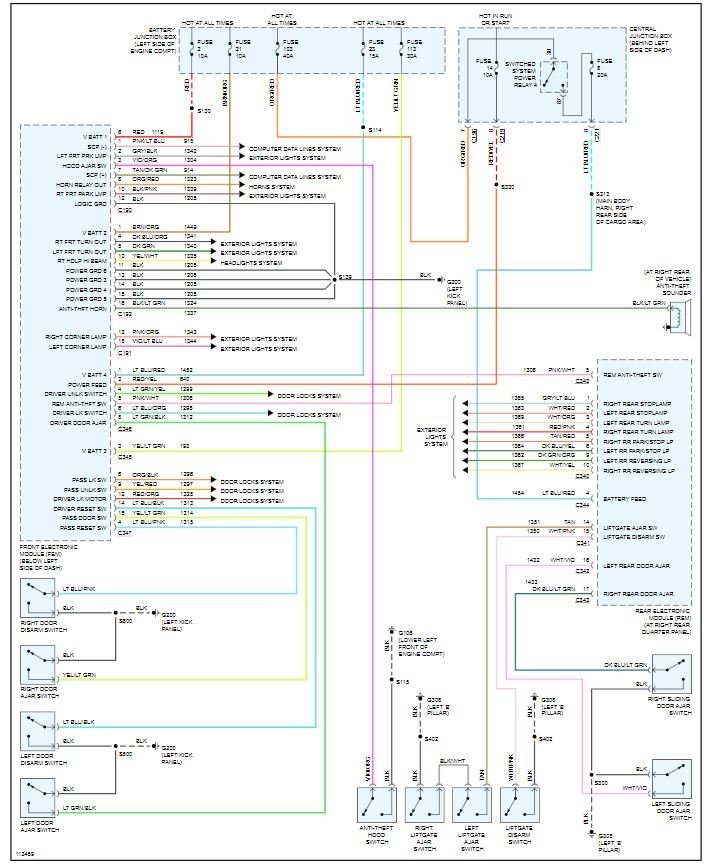

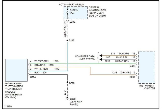

From what I can find out, there is information on the old cluster that needs to be downloaded and the upload that information to the new cluster. I think it has something to do with the odometer and the ignition key. There doesn't appear to be any simple button to push for this one
I have attached a diagram of the wiring for the systems below, check them out and get back to us
