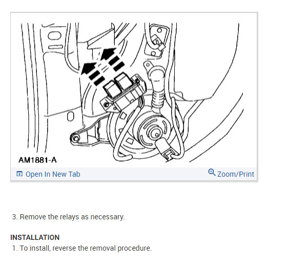

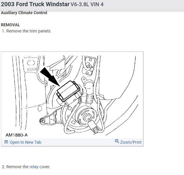

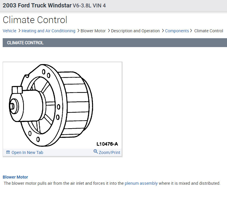

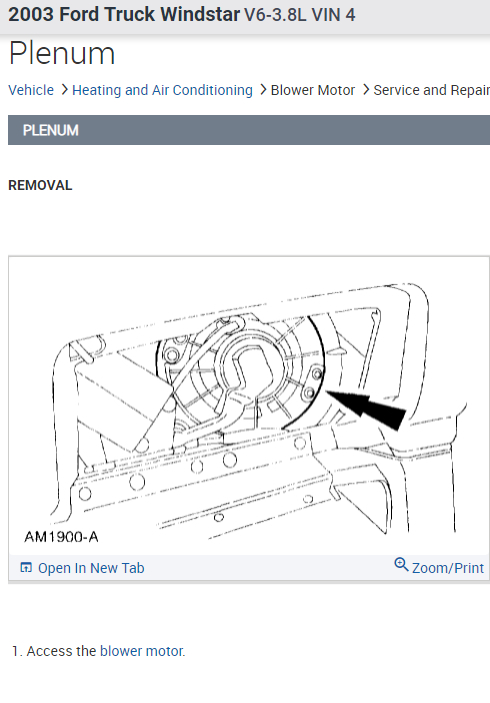

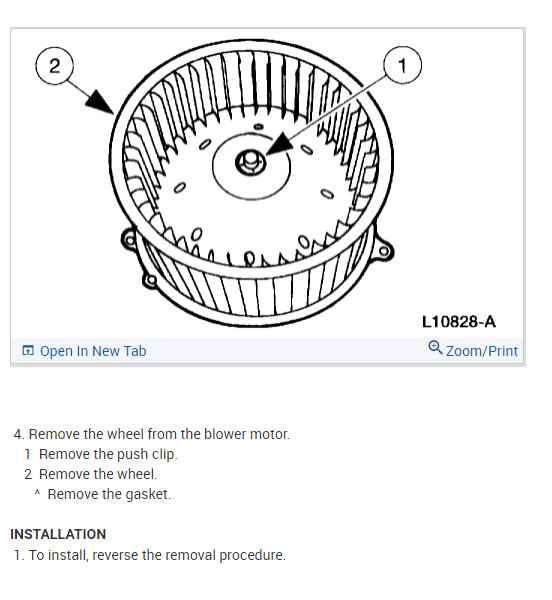

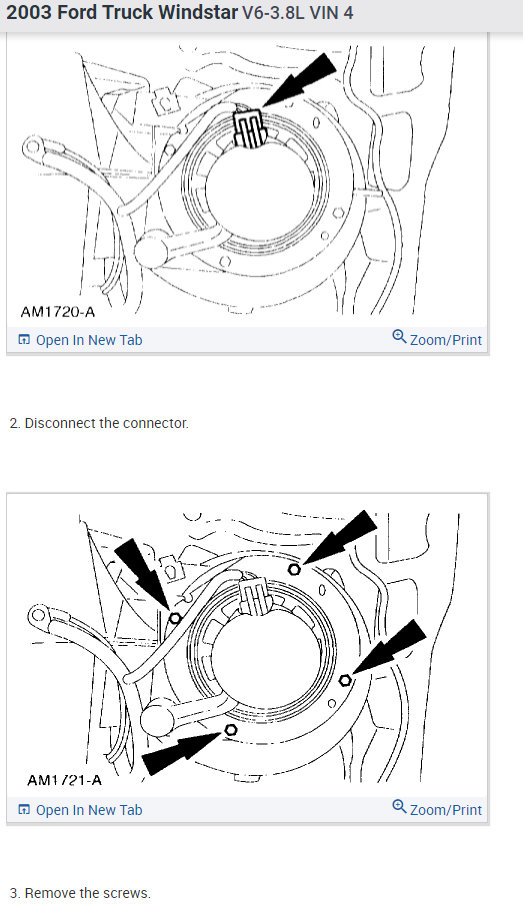

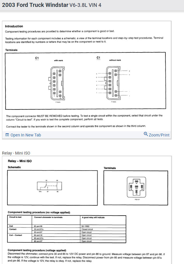

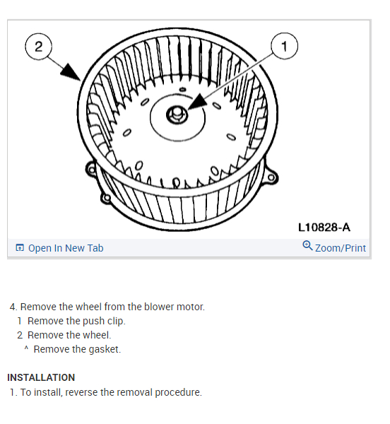

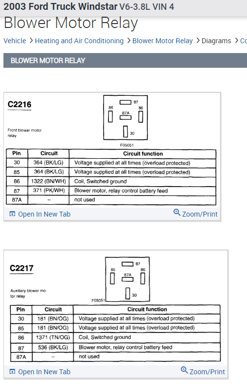

There are few reasons for the blower motor not to turn on.
You could have a bad motor, faulty relay, faulty resistor or a wiring issue.

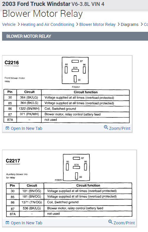

First thing should be checked is the blower motor relay.
Make sure the relay is functional.
Here is how to test the relay:

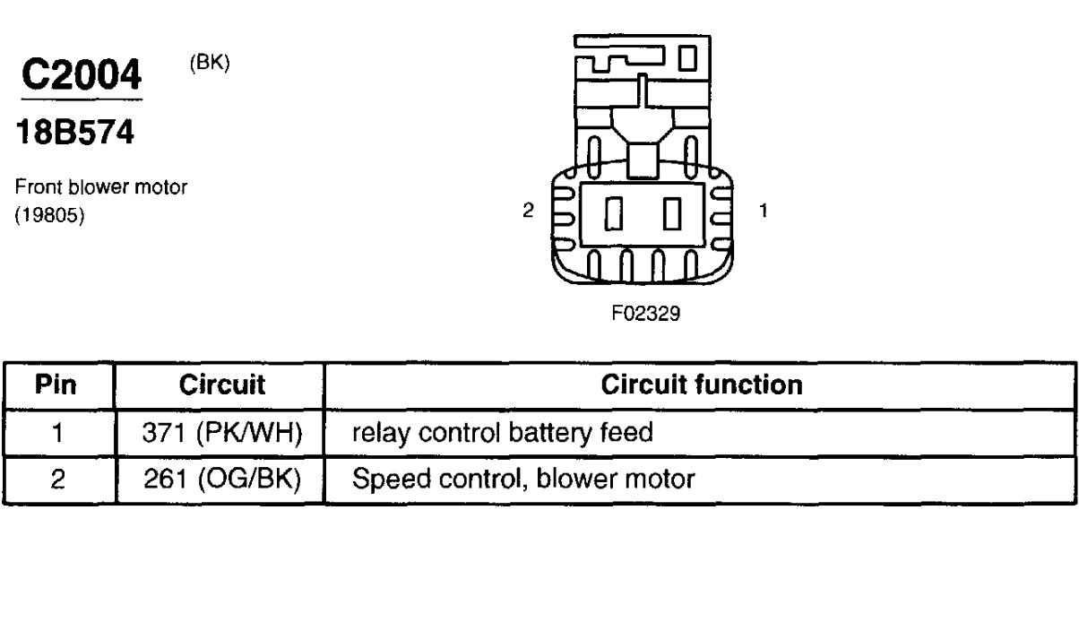

If the relay is good then the next item to check would be the blower motor.
https://www.2carpros.com/articles/blower-fan-motor-works-on-high-speed-only

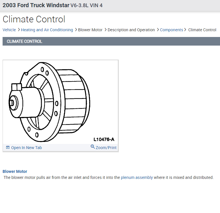

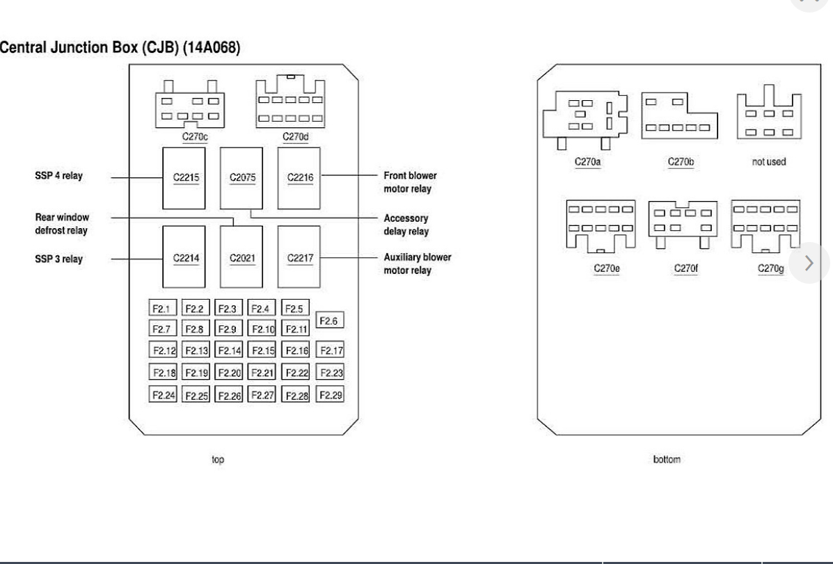

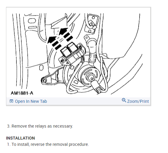

I have attached the blower motor replacement instructions for your reference. Also included the fuse block diagram, that shows the relay location.
