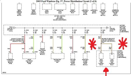

Electrical problem
2003 Ford Windstar 6 cyl Front Wheel Drive Automatic
Tryign to trace a wiring issue unde the hood. There seems to be a wiring harness that runs aross the radiator support. A number of the wires in this harness are frayed.
I am looking a for a diagram and wire color codes for 2003 Windstar under hood.
ANy info regarding what diagram controls would be helpful

Hello .. thanks for the donation .. much appreciated We do not have a wiring diagram just for underhood .. the diagrams are in category's ..(ie.) headlamp circuit,engine performance cicuit, etc. etc. .. we could really do with tracing the wiring harness to where it comes from or goes to ? .. or if you could trace the frayed wires ? let me know

The wire in question is a black with orange tracer.
It is the harness that runs negin the top of the radiaotor..
I have an online subscription to Alldata but it is not the full blown database and I cannot figure out what/wheer to lok for wiring schematic.

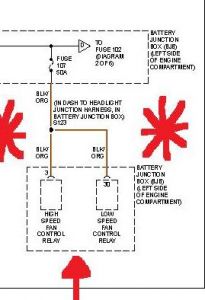

Hey chalky This is the only black wire with orange tracer i can find and it fits the description of where you said the wires are located .. hope this helps .. let me know

Any chance you could email this pic to me? I am having a hard time reading the info and when I blow it up, it gets worse.

Sure send me an email to dave@2carpros.com or can you see this better ?

OK, I see it now. Fan speeds.
