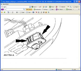

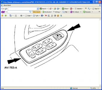

hi...the control for the mirrorsonly works in two functions....pan ouy and pan up on both sides...the down and pan in isnt working....how do i replace switch

SWITCH - EXTERIOR REAR VIEW MIRROR CONTROL REMOVAL CAUTION: Use a shop towel or similar material between the tool and the front door trim panel or damage to the front door trim panel may occur. Disengage the window regulator control switch from the front door trim panel. Remove the exterior mirror control switch. Disconnect the electrical connector. INSTALLATION To install, reverse the removal procedure. There you go.
