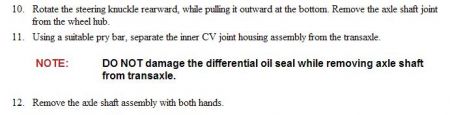

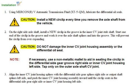

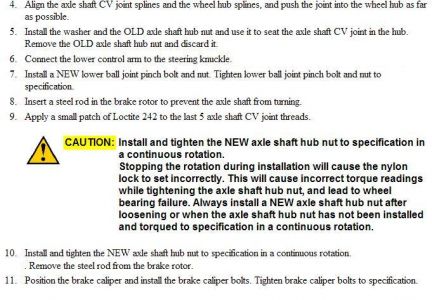

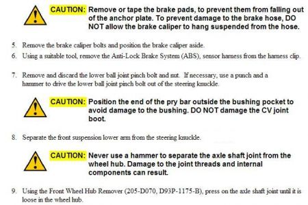

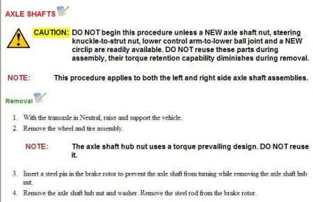

Could I see a video on how to remove and replace the drive shaft?
Feb 11, 2010 at 3:07 PM
BLUELIGHTNIN6
  • 16,542 POSTS
Sorry but we don't have a video series for that type of repair yet. However, here are the step by step procedures for replacing your vehicle's axle shafts..
