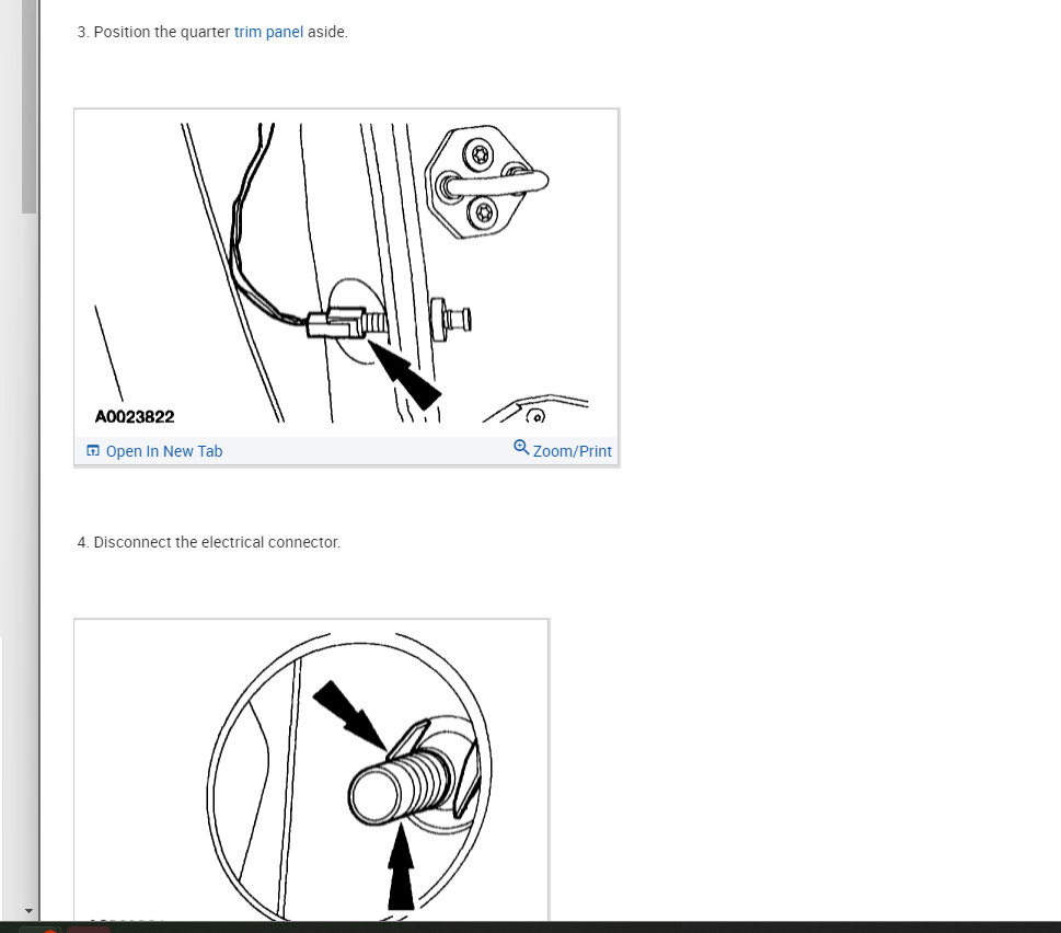

When all doors are closed the door ajar light stays on Why?
Jan 13, 2010 at 5:11 PM

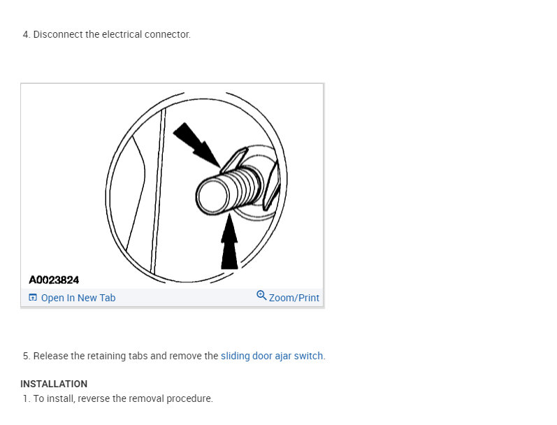

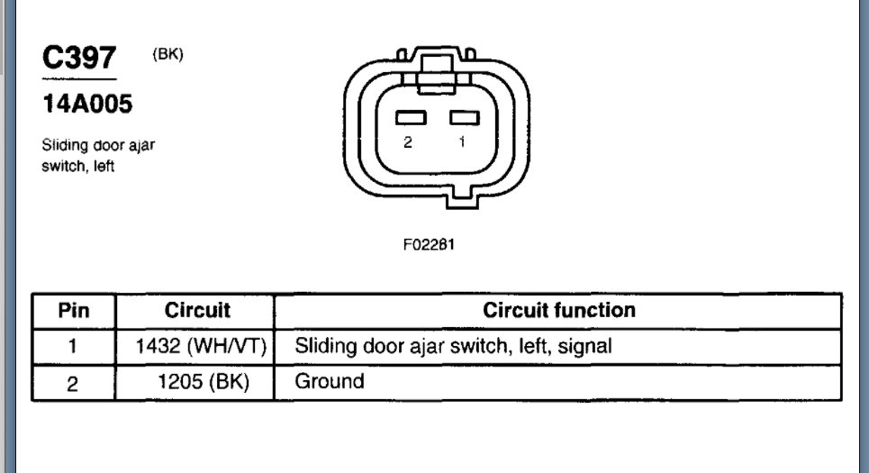

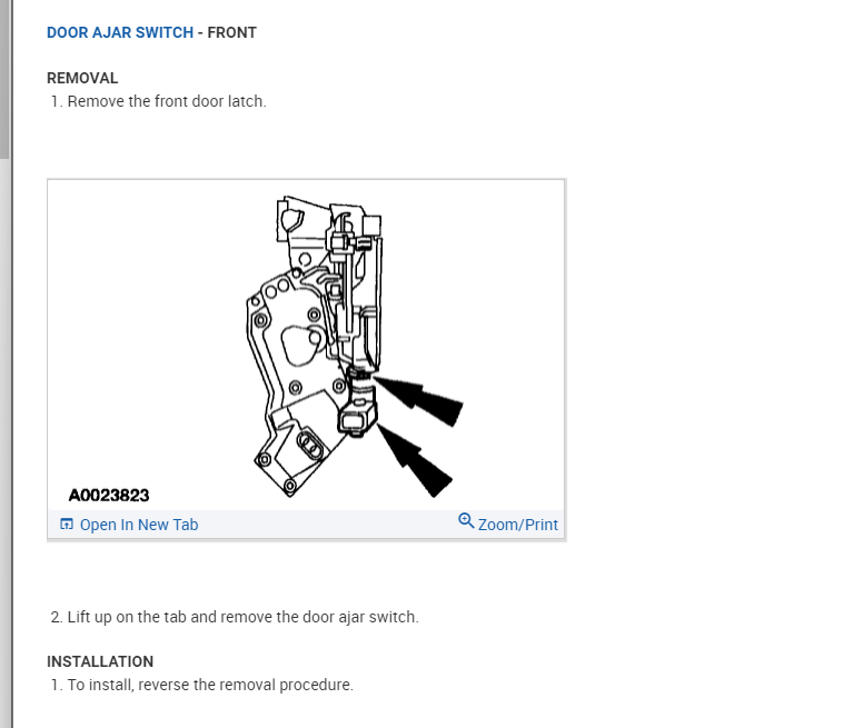

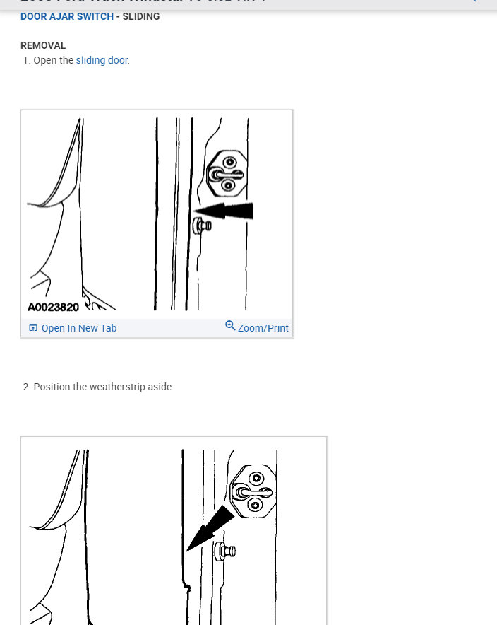

More than likely this is just a failed door switch. So, we need to figure out which door this is by going to each switch and jumping the connector pins and see when the light turns out.
If you want to check the voltage and ground, then this guide will help with that as well:
Basically, this is a simple two wire switch that when it is closed, the door is seen as closed and then when the switch is opened the door is open.
So, if we jump the switch to ground the voltage the light will go on when you do this to the affected switch.
The only time this doesn't work is when you have more than one failed at the same time but that is very rare.
Please run through this and let us know what you find.
