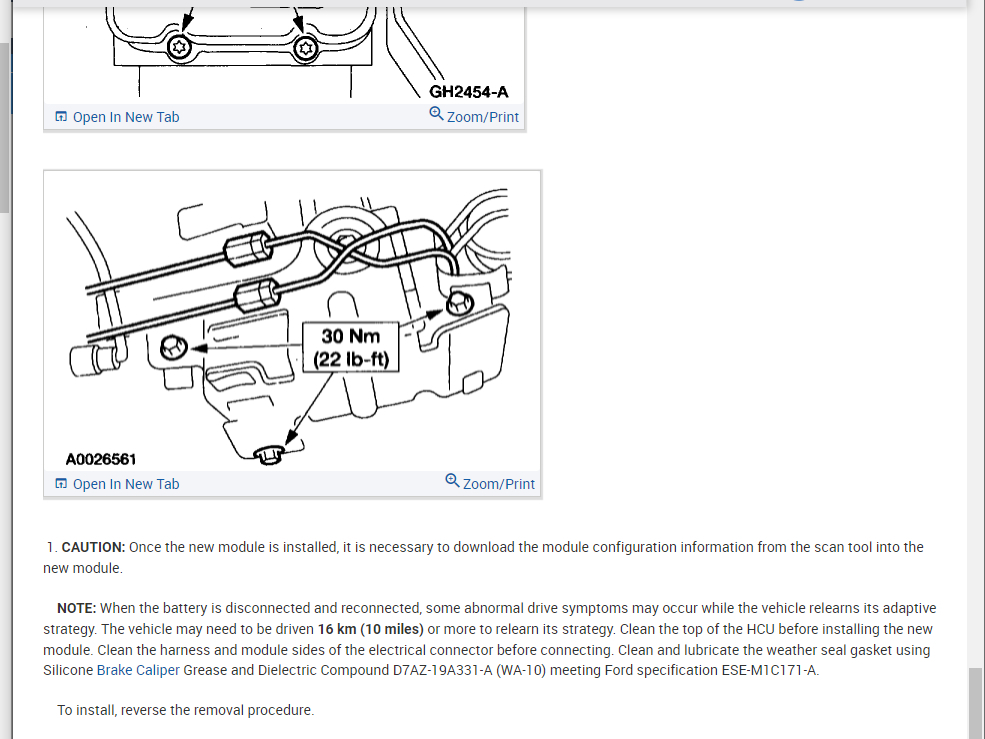

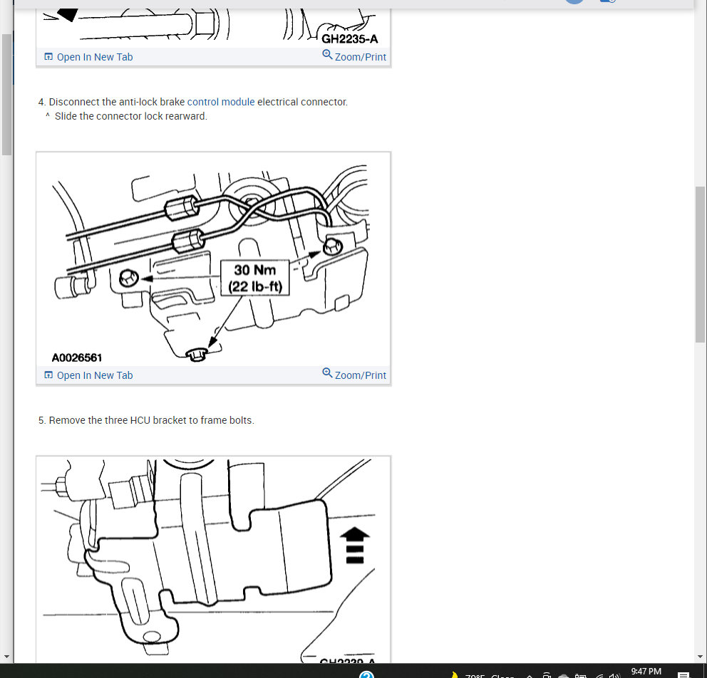

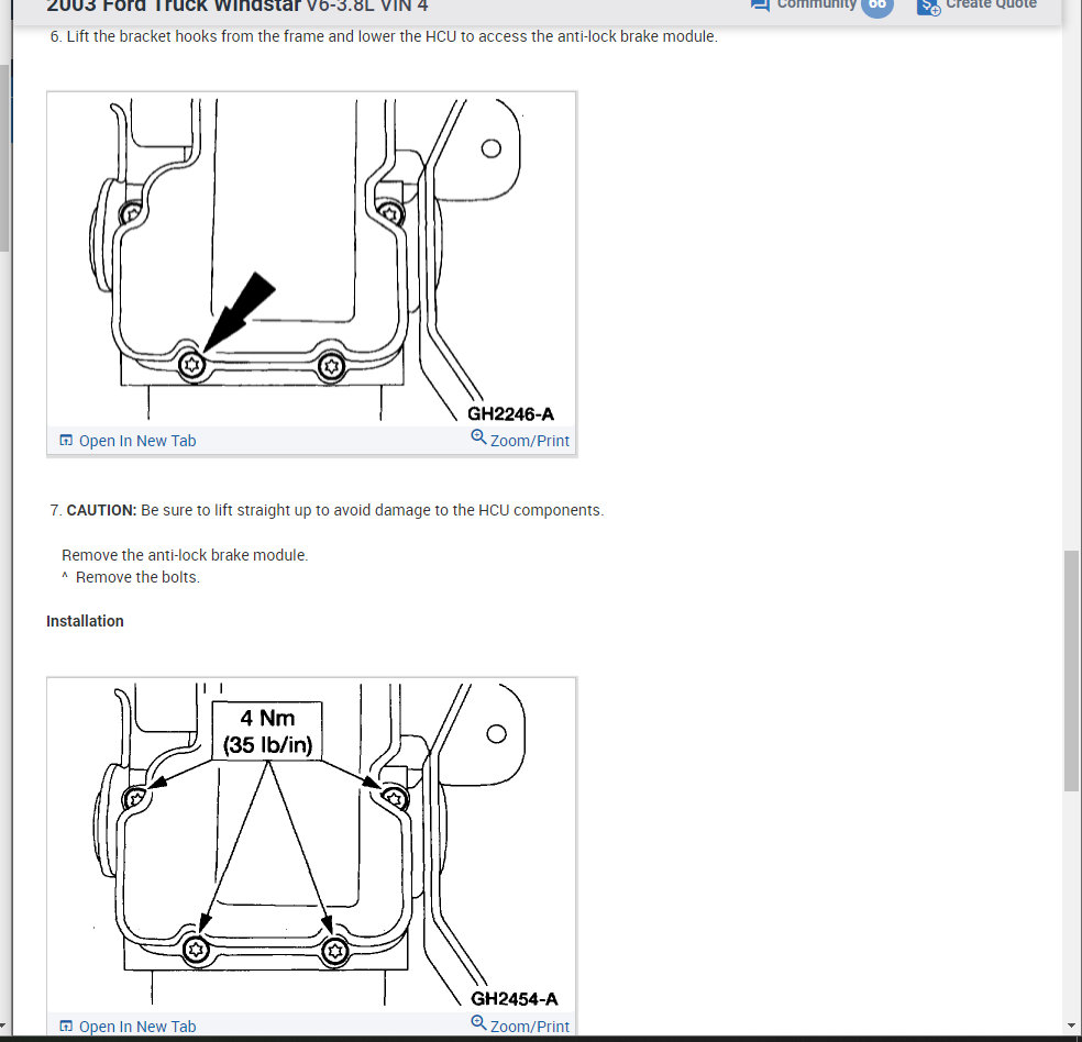

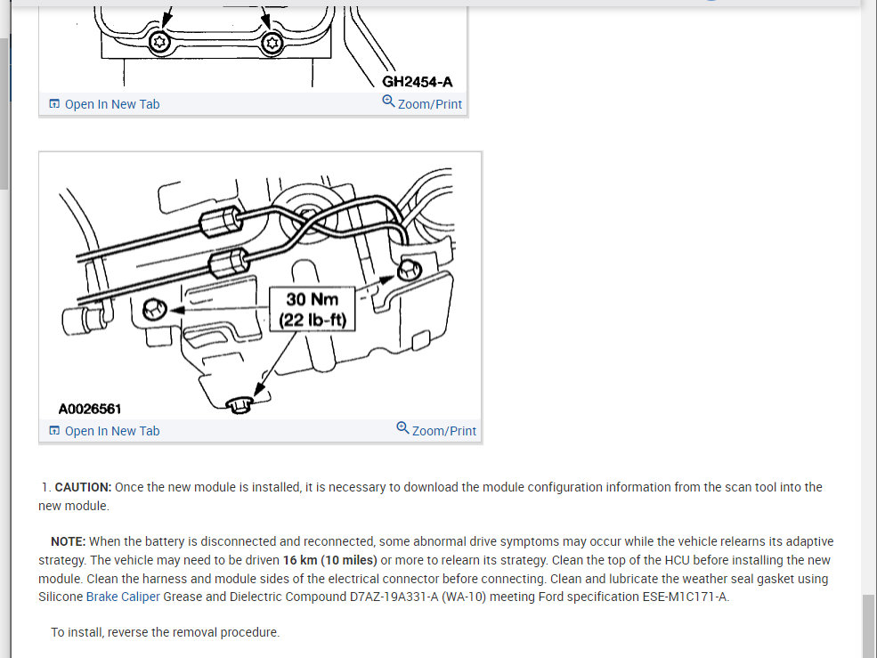

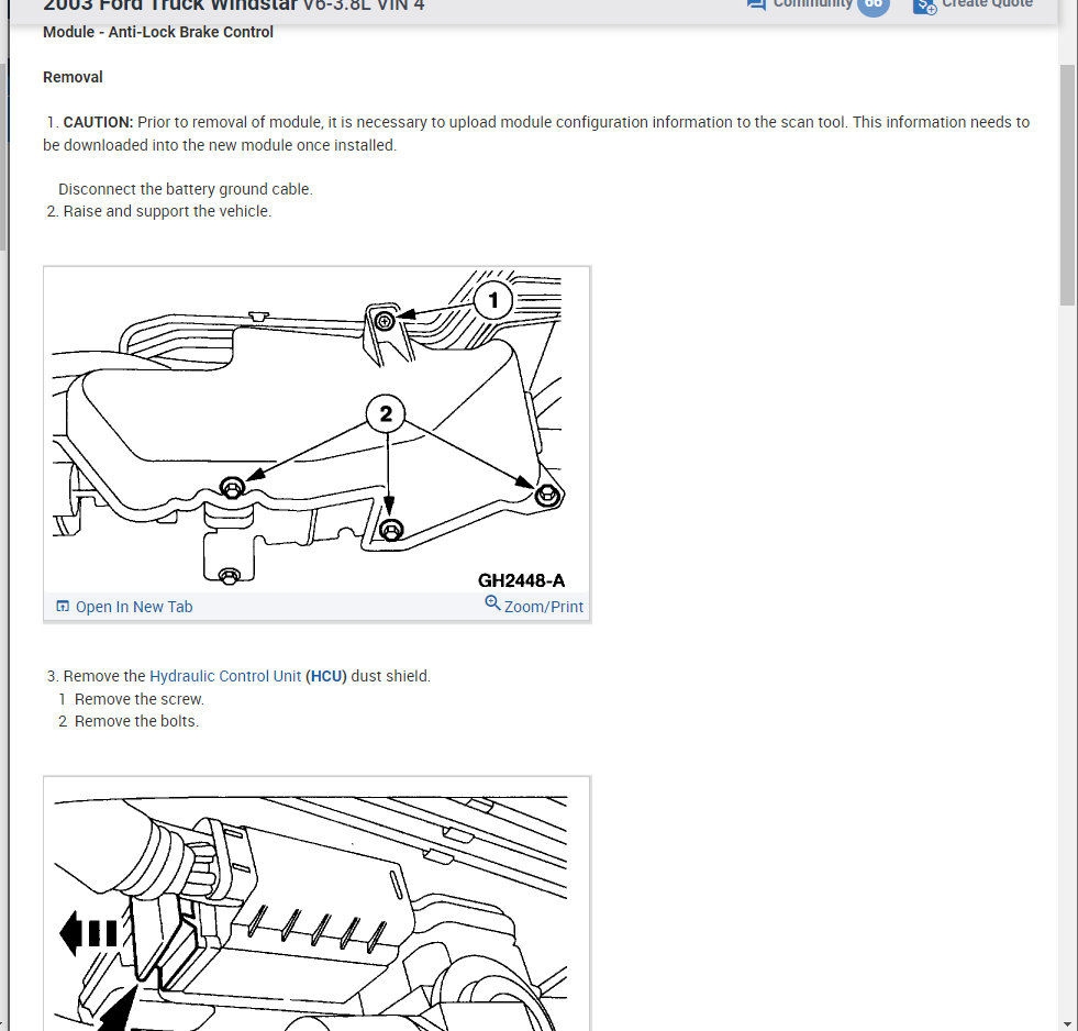

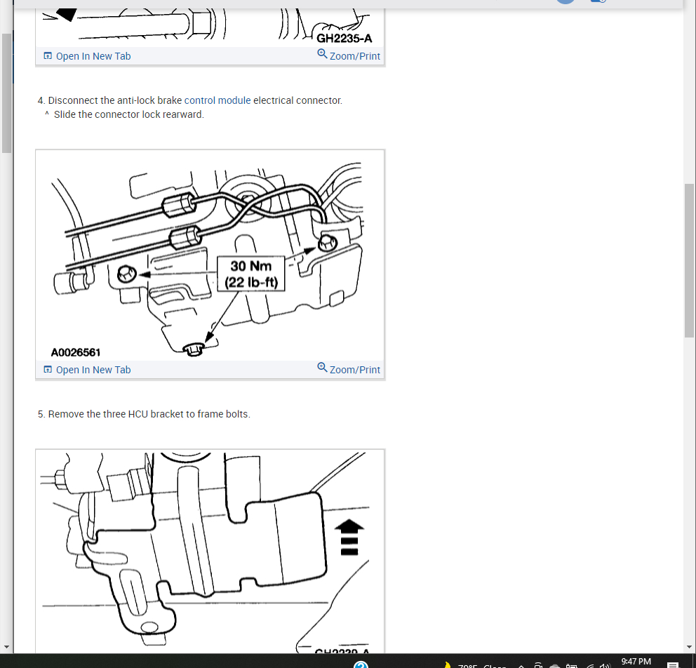

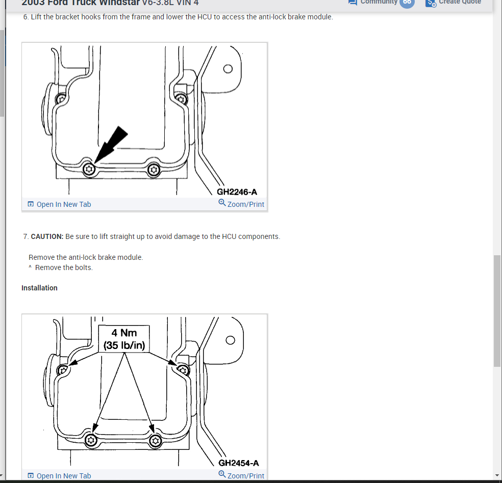

I attached the process below but I have seen this a number of times on these vans where the ABS will get water/moisture in the connectors and cause issues like this when it is wet outside.
