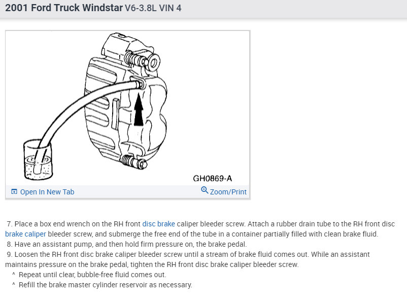

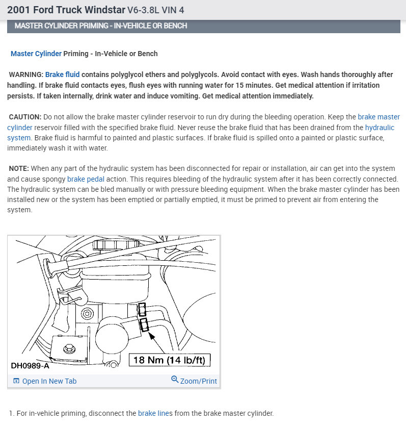

My brake pedal is going to floor. we changed front brakes and one caliper and the master cylinder and bled the brakes, but it is still happening. so we are at a loss as to what the problem is.

There are few reasons for the brake pedal to go to the floor.
https://www.2carpros.com/articles/brake-pedal-goes-to-the-floor
It can be due to a leak in the system, air in the brake line, bad master cylinder or calipers.
Inspect the other side that you have not replaced the caliper. Also look for any leaks.

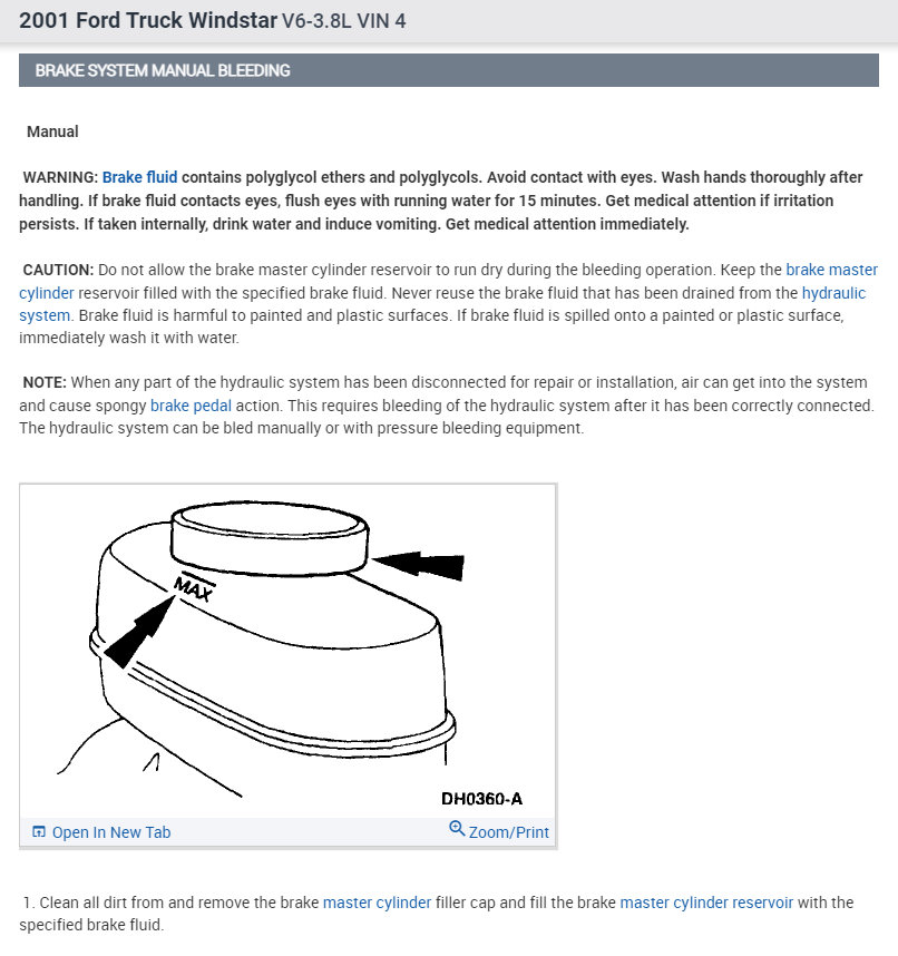

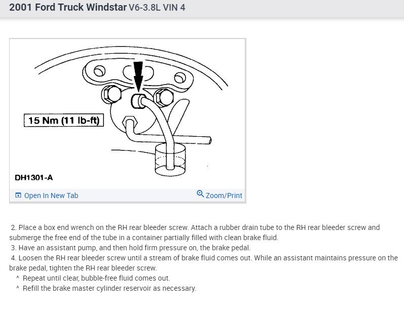

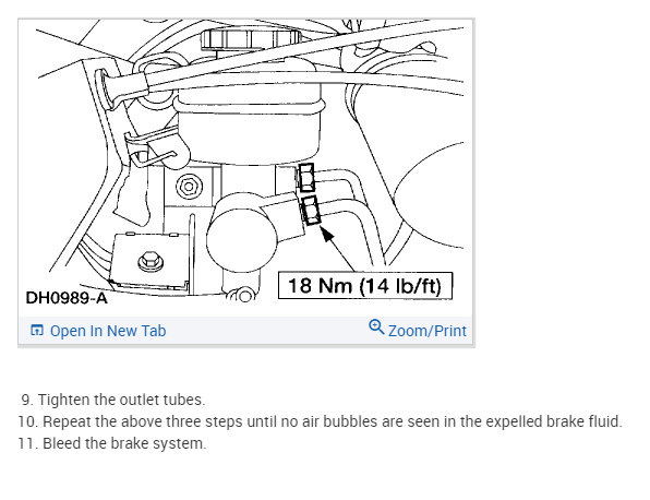

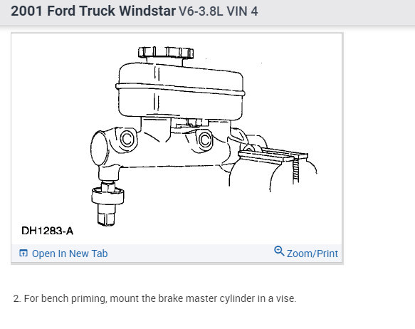

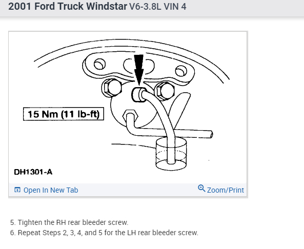

Keep in mind that if the proper sequence does not get followed the brake lines can still have air in it even after bleeding.
Here is a proper method of brake bleeding:
https://www.2carpros.com/articles/how-to-bleed-or-flush-a-car-brake-system

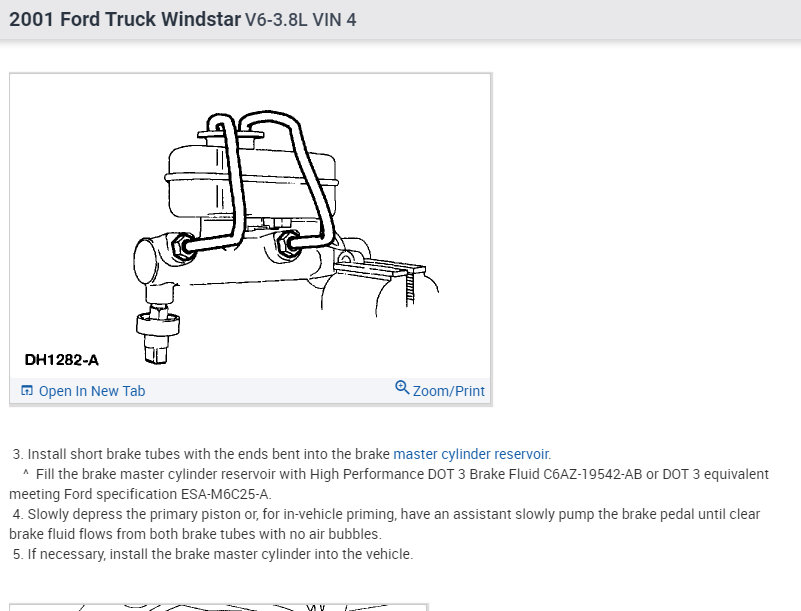

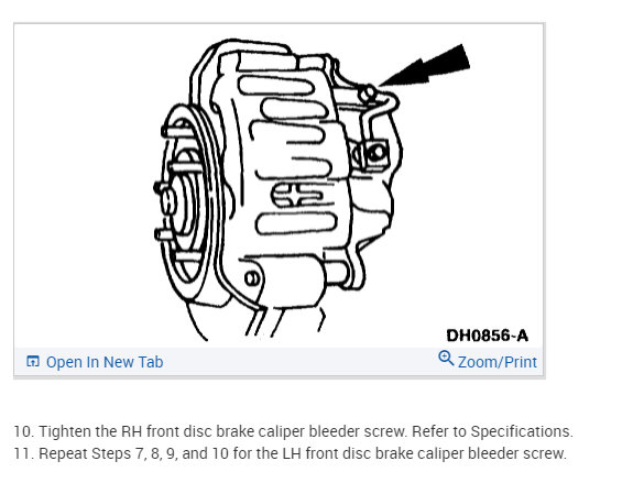

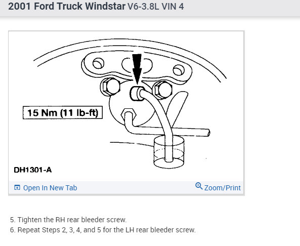

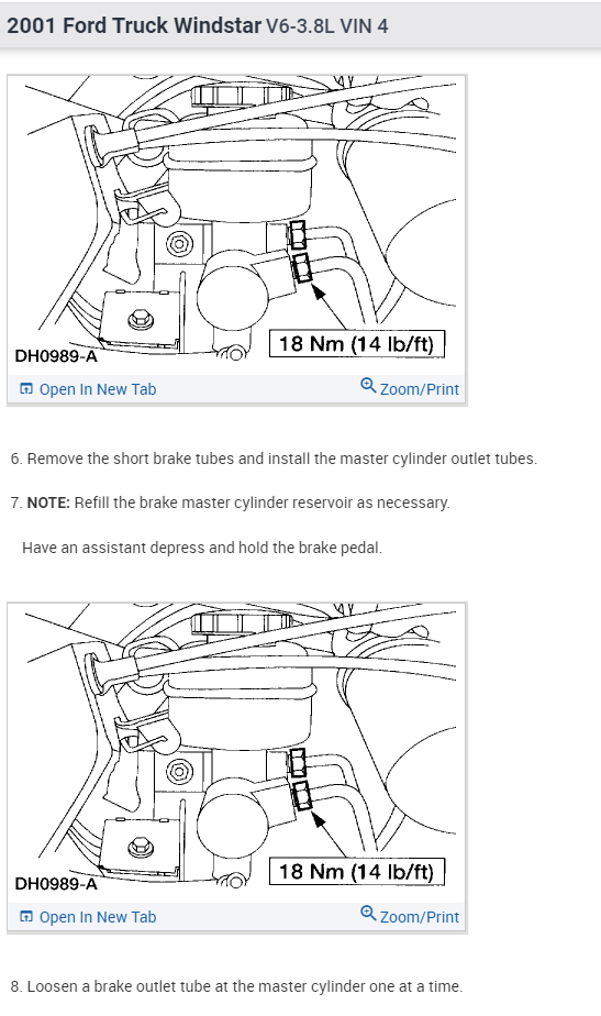

I have attached the brake bleeding as well as master cylinder priming procedure below.
