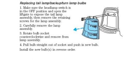

how do you change brake light bulb on 2003 windstar van. do you do it from inside of van of do you have to do it from outside. im sure it is probably simple but i just need to know. thanks

Welcome to the forum, I found this in your owners manual, if that is what you need?
https://images.2carpros.com/forum/automotive_pictures/170934_windstar_lamp_assembly_1.jpg
