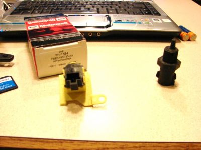

I found the sensor today. It is located low behind the grill just to the left of the license plate bracket as you look at the front of the Van. It is no wheres near parallel with the alternator. Looks like it is located behind the grille, forward of the radiator core support. It has to be isolated from engine compartment temperature, so it will be where fresh air can hit it. What made it difficult was Ford sending me the wrong part and me using the incorrect part as a guide for the part to be replaced. Being a Ford, I am sure I will be replacing this piece again anyways.
https://images.2carpros.com/forum/automotive_pictures/323422_DSC00902_1.jpg
The black cylinder object is the correct sensor. The yellow black is not what you want.

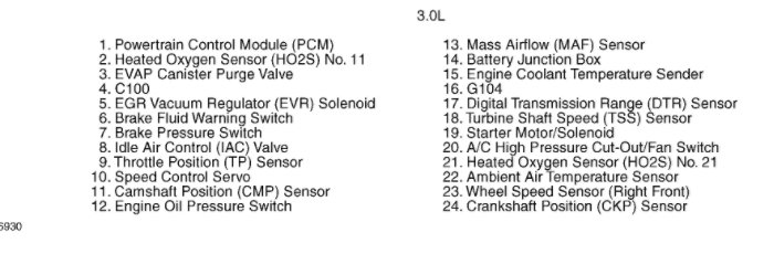

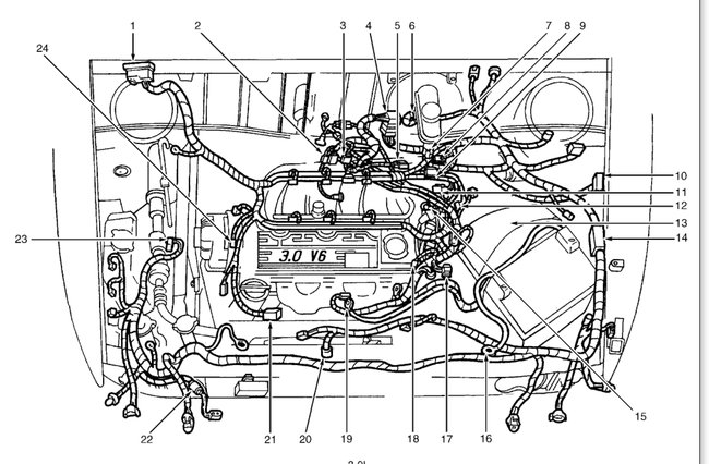

The ambient air temperature sensor is located in the air intake tube. Here is a guide that show it being disconnected.
Number 25 is the sensor, and it does not look like it may be either behind the bumper or clipped onto the radiator/condenser.
https://www.2carpros.com/articles/replace-an-air-intake-boot
Please get back to us.
