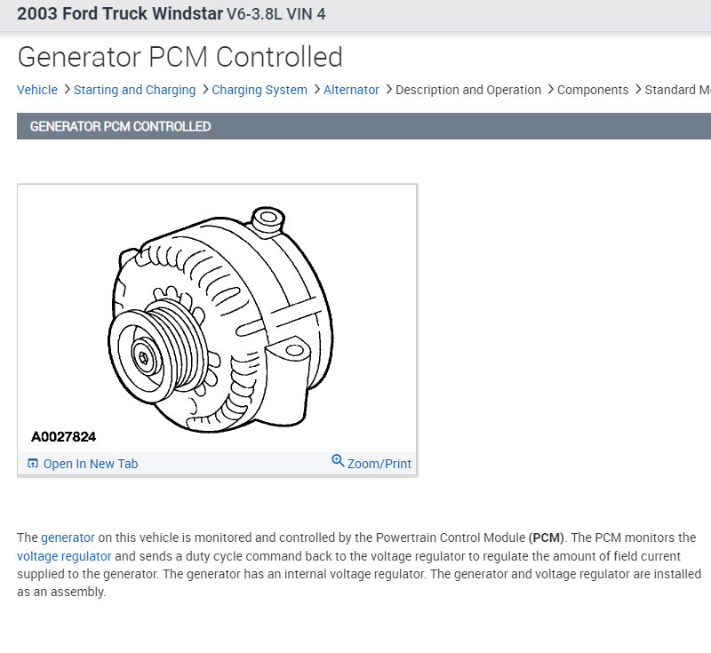

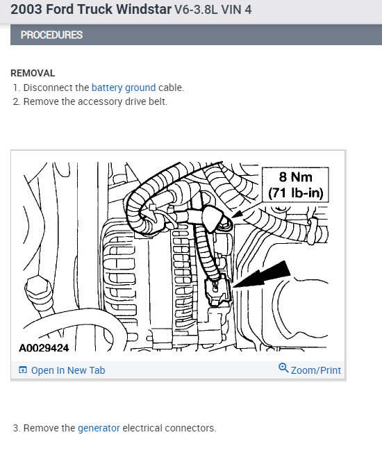

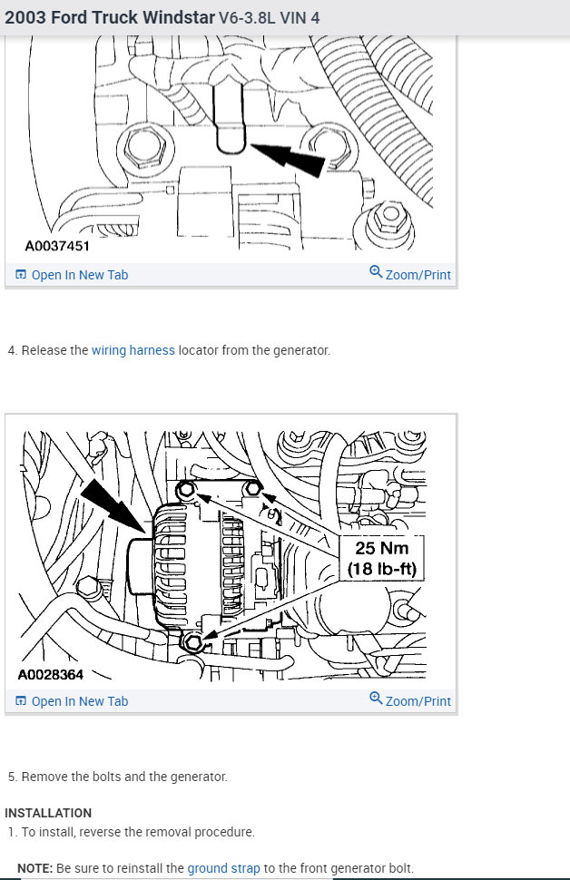

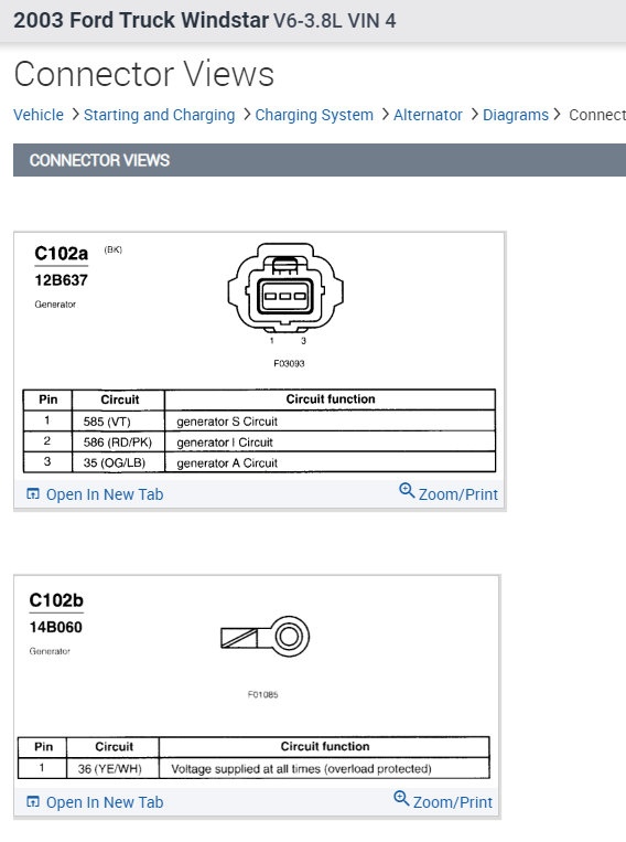

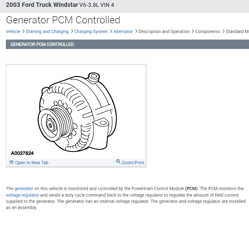

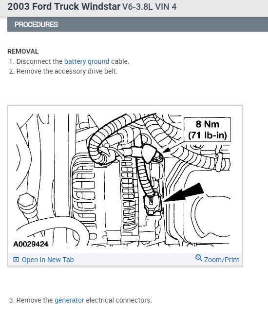

Sounds like the regulator in the alt may be bad.The light may be coming on due to overcharging (almost 15 volts). Be sure the ground on the engine is clean and tight.
This guide should help test it.
