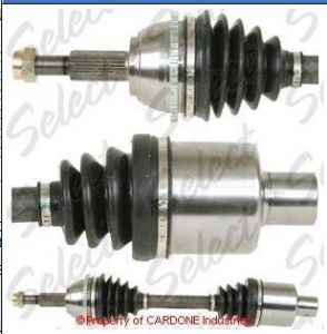

Hello, yesterday while diving the van, we heard a pop and the lost all "pull" from the van. We can put the car in gear, but nothing happens. We tried putting the car in all gears still nothing. Has the transmission went out completely or could there be something else causing this??

Hello, just a thought, you might check the halfshaft. Have helper start the vehicle, put in drive, foot on the brake, while you look at the halfshaft, if it is turning, maybe a bad joint.
