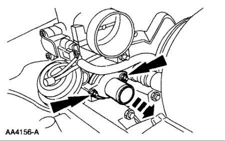

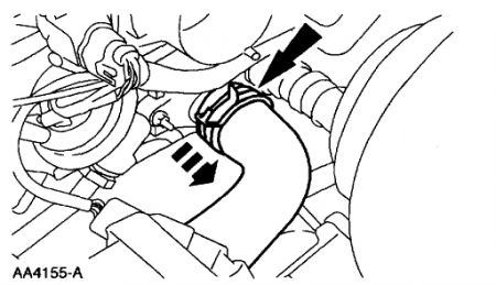

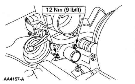

Where is the thermostat exactly? Are there diagrams somewhere I can look at without buying a manual?
Oct 10, 2010 at 1:28 AM
  • 75,992 POSTS
Thermostat Removal 1.Drain the engine cooling system. 2.Remove the air cleaner outlet tube.
https://images.2carpros.com/forum/automotive_pictures/12900_t1_38.jpg
3.Remove the upper radiator hose from the water hose connector.
https://images.2carpros.com/forum/automotive_pictures/12900_t2_24.jpg
4.NOTE: Mark the location of the vent pin before removing the thermostat. Remove the bolt, nut, water hose connector and thermostat, and discard the gasket. Installation
https://images.2carpros.com/forum/automotive_pictures/12900_t3_11.jpg
1.To install, reverse the removal procedure. 2.Fill the cooling system. https://www.2carpros.com/kpages/auto_repair_manuals_alldata.htm
