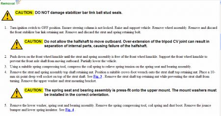

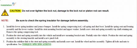

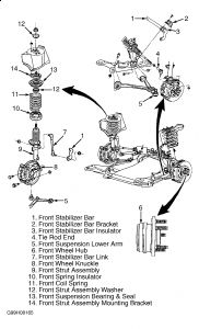

how to remove front struts
Mar 30, 2009 at 8:05 PM
OBXAUTOMEDIC
  • 3,711 POSTS
Hi James, Here's the info.... I will also email the text to you for easier reading...
https://images.2carpros.com/forum/automotive_pictures/188069_02winstarstrutremove_1.jpg
https://images.2carpros.com/forum/automotive_pictures/188069_02winstarstrutinstall_1.jpg
https://images.2carpros.com/forum/automotive_pictures/188069_02windstarexplodedstrut_1.jpg
