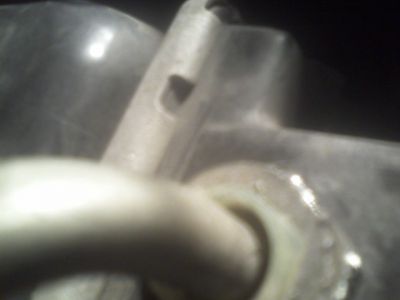

How do you take the radiator out.I really just need to know how to take transmission line out of the radiator.There a nut and the line going thourgh it and it has plastic white clip or something inside the nut and over that there a metal clip or somthing but i already got that off.Here some pic below they kinda suck.[img:1bc4561440]http://www.2carpros.com/forum/automotive_pictures/488536_022310122602_1.jpg[/img:1bc4561440]
[img:1bc4561440]http://www.2carpros.com/forum/automotive_pictures/488536_022310122800_1.jpg[/img:1bc4561440]

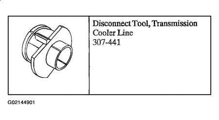

you need Ford's special disconnect tool, contact local Ford dealer to rent or purchase it..
https://images.2carpros.com/forum/automotive_pictures/261618_Graphic_351.jpg
https://images.2carpros.com/forum/automotive_pictures/261618_Graphic2_50.jpg
