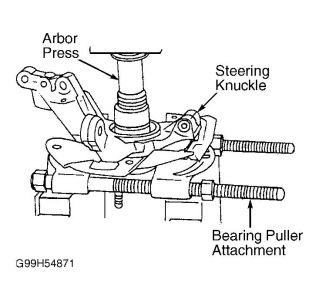

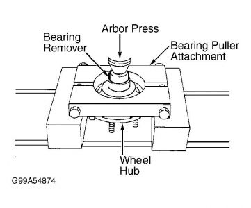

I need a little help on how to replace the front wheel bearings on a van. How do you get the bearing out of the van do you have to take apart the whole front wheel assembly
May 12, 2008 at 4:28 PM
MIKE H R
  • 3,094 POSTS
The bearings are pressed on and off.

Remove the three bolts holding the hub assembly in place (note that these are locktited in place and you will not touch them with a low end impact wrench, it is easier to use a long handled 1/2 drive ratchet and socket) and push out the old hub assembly from the steering arm (it may seem like it is pressed in, but it is most likely just rust and corrosion that is holding it in place, make sure your new part is the same as your old part and hammer the old bearing hub assembly out).
Once you have removed the old bearing assembly, clean up the opening with a wire brush, install the new bearing assembly (only goes in one way) and use removable locktite on the threads of the three bolts (as i could not find any torque specs. on this, you will have to use your best judgement, but I recommend not installing any of these bolts with an impact or air ratchet, as you will not be able to feel how tight they are getting).

After I remove the three bolts will the hub assembly be completely free of the car, so that I can pound the old bearings out on a workbench, or is the hub assembly still attached to the car?
Jul 17, 2010 at 3:16 AM
MIKE H R
  • 3,094 POSTS
what I have is that the bering are pressed on. If you use a hammer watch out so you do not swell the end shaft.
