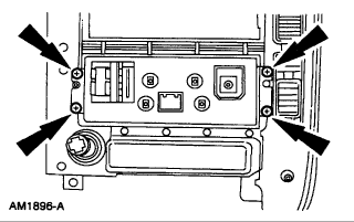

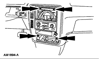

heater temp control makes a steady rithimic clicking sound as it is moved to warmer position. the clicking frequency increases the further right (warmer) you move the control. I need to access the control motor and other parts behind the dash but I don't know how to remove the dash area without damageing it.

Hello - I think this is what you are asking for. Control Components Notes REMOVAL Disconnect the battery. CAUTION: The slider knobs are illuminated using a LEDs. Use care not to damage them when removing the slider knobs.
https://images.2carpros.com/forum/automotive_pictures/248015_1_55.gif
Remove the ash receptacle. Remove the audio unit.
https://images.2carpros.com/forum/automotive_pictures/248015_2_67.gif
Remove the screws.
https://images.2carpros.com/forum/automotive_pictures/248015_3_46.gif
Unsnap the panel.
https://images.2carpros.com/forum/automotive_pictures/248015_4_35.gif
Disconnect the connectors.
https://images.2carpros.com/forum/automotive_pictures/248015_5_24.gif
Remove the control assembly. Remove the screws. INSTALLATION To install, reverse the removal procedure. NOTE: When the battery is disconnected and reconnected, some abnormal drive symptoms may occur while the vehicle relearns its adaptive strategy. The vehicle may need to be driven 16 km (10 miles) or more to relearn the strategy.
