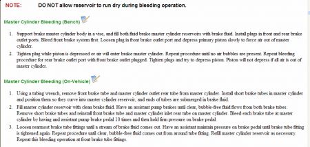

I have a 1999 Ford Windstar 6 cylinder 3.8L Minivan LX. I'm leaking a little brake fluid where the master cylinder meets a metal drum looking part. Will you provide instructions on how to replace this master cylinder and instructions on how to bleed the brake fluid?

Hi Frank, Here ya go...
https://images.2carpros.com/forum/automotive_pictures/188069_99windstarmastercylindrremove_1.jpg
https://images.2carpros.com/forum/automotive_pictures/188069_99winstarmastercylindbleed_1.jpg
The Bleed Sequence is Right Rear, Left Front, Left Rear then Right Front. I will also email the Remove and Master Cylinder Bleed. .
