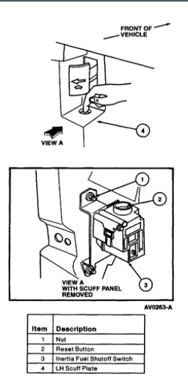

fuel pump reset switch location
1998 FORD WINDSTAR
186,000 MILES • 6 CYL • 2WD • AUTOMATIC
ROWERBOAT
where is the switch?

The inertia switch is located on the left scuff panel. I've attached a picture below. Hope this helps and thanks for using 2CarPos. Check out the diagrams (Below). Please let us know if you need anything else to get the problem fixed.
