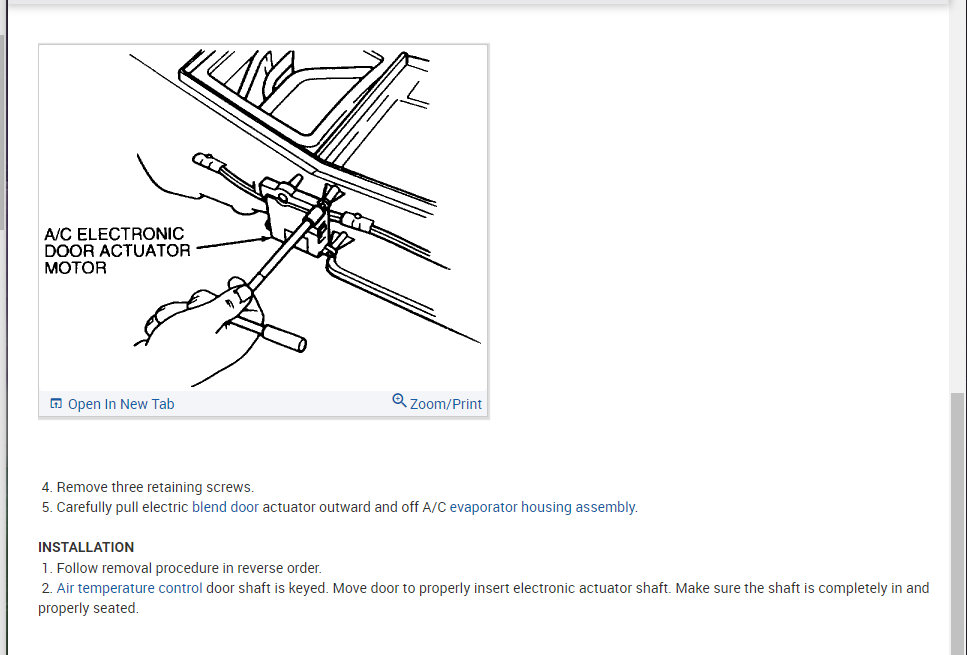

Hi I have no heat at all up front but have heat in the rear was just working before?
Thursday, December 11th, 2008 AT 7:49 AM

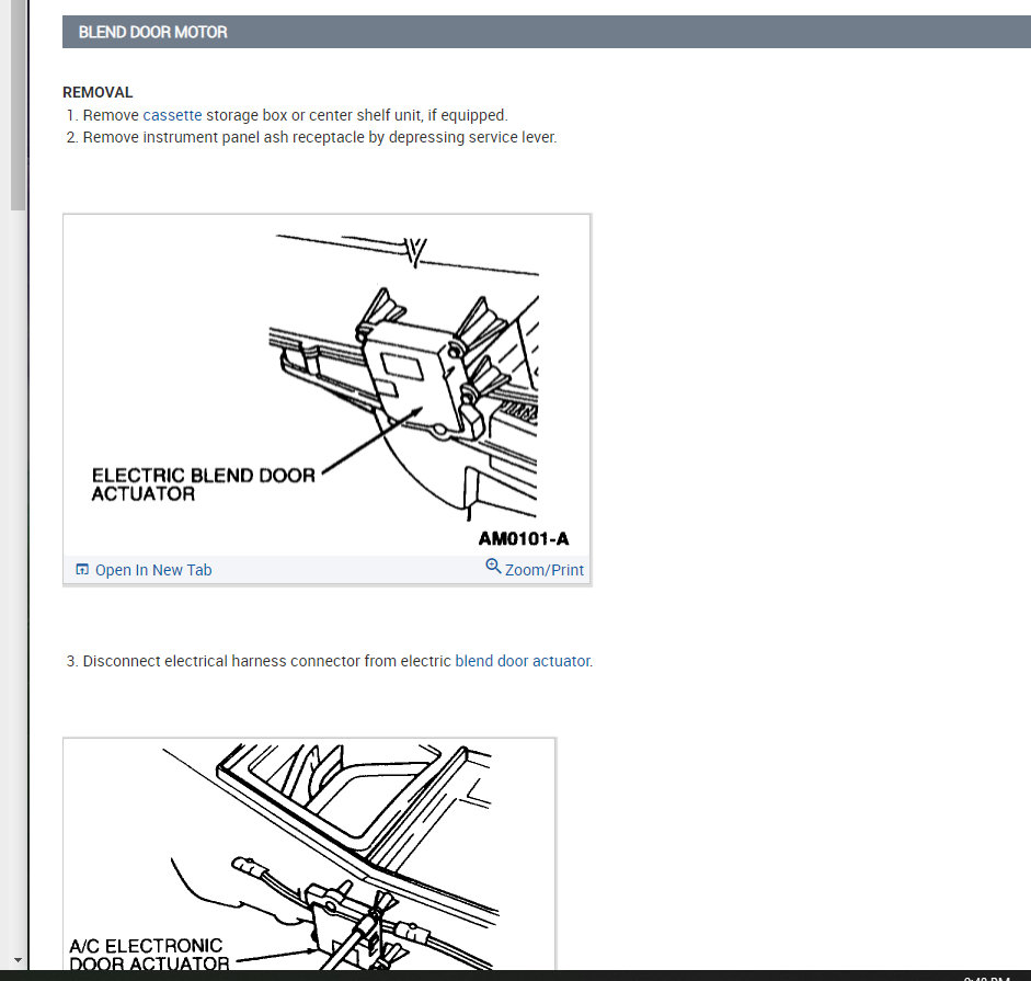

This is more than likely a blend door issue as you have separate systems in the van.
Here are a couple guides that will help with figuring this out:
https://youtu.be/SNRb6pSwYuU
https://youtu.be/Eqf-H3COtSo
Below you will find the process from the manual that will help with replacing this.
Please run through this info and let us know if you have other questions.
