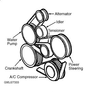

How do you release the tension pulley and then reapply the tension?
Thursday, December 31st, 2009 AT 2:59 PM
DOCFIXIT
MECHANIC
18,828 POSTS
See the square cut in tensioner body see diagram
Use ratchet or breaker bar push tension sprig remove belt
