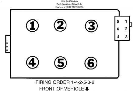

Need smknd of scheme or just description of cylinders work order in 3,8L Ford Windstar engine. Ford PDF manual doesn't provide such information. Also don't know exact number of cylinders.

https://images.2carpros.com/forum/automotive_pictures/62217_FO3_1.jpg
This what you need? V6 SIX cylinders

Thanks, I think it's what I need. Will try to switch them today. Again, appreciate your help!
