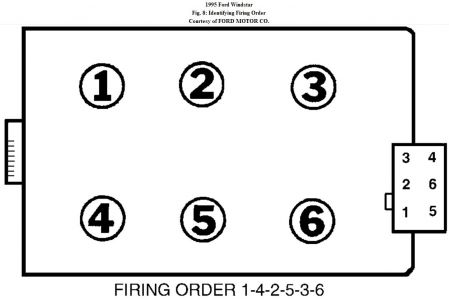

1995 Ford Windstar FIREING ORDER
1995 FORD WINDSTAR
BOFIYO1
1995 Ford Windstar 6 cyl Front Wheel Drive Automatic
FIREING ORDER FOR FORD WINDSTAR

https://images.2carpros.com/forum/automotive_pictures/62217_FO_15.jpg
