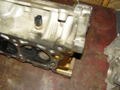

where is temp. sending unit

Engine coolant temp. sensor is to the inside of the driverside head. Remove the alternator and you can get to it.
