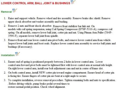

Suspension problem
2001 Ford Truck 6 cyl Two Wheel Drive 1ooooo miles
Do you have to relieve the torsion bar tension to remove the lower ball joints on a 2001 ranger

https://images.2carpros.com/forum/automotive_pictures/261618_Noname_2089.jpg
