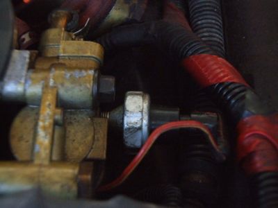

I will look into the pressure once I can get my hands on a tester. BTW, it started running today after cranking it with ether(I know its bad for the truck, I just used a little and no glow plugs). It idled for an hour then died when I tried to drive it. I got it running again later. Now it seems to drive fine but it lopes at a light. There is a component on the fuel bowl that is dripping fuel slowly now. The parts guys cannot identify it. It looks like a oil pressure sensor and has a red wire with a stripe on it. The wire connects like a tiny spark plug. It's right next to the shrader valve mentioned in the testing procedure. What is this?

Can you post your reply to my email here? I need to know exactly what colors the wire is, is it red with a green stripe?

No problem.. I'm new to this forum sry. The wire is red with yellow stripe. The red with green stripe comes off the solenoid switch. This wire goes to the ? device on the drivers side.

Looks like the sender for the wait to start light on the dash.
I will need the series of your truck as well, 150? 250? 350? Super duty?

OK, it's an f-350. But this device is right on the side of the filter bowl. It has fuel flowing through it. As I said earlier, it's leaking fuel out the side. How could this have anything to do with the glow plug circuit? I seems like some sort of pressure switch, regulator, cutoff ect.

It's a typical sending unit(pressure sensor type) turns on warning lamps. If it leaks, replace it.

Thank you. So this leaking will not effect the non starting situation? I managed to get it running for a few miles and noticed this sensor was leaking. It drove around a few miles with only one stutter. I started it the next morning and it idoled fine for several minutes. Then, I pulled out of the driveway and it died. It would not start with or without either. It sputtered a little with a quick burst of ether but nothing else. I drained the fuel bowl into a cup and found no water. The fuel smells funny though. The last fuel I got was extremely clear and odorless. I'm starting to think something is wrong with my fuel.
