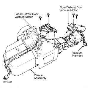

need to find some help as soon as soon as possible to change my heater coil.

not sure which truck you have this description is for F250 HEATER CORE Drain cooling system. Disconnect heater hoses. Remove glove box for access. Remove RABS module mounting screws and move module aside. Remove 7 screws attaching heater access cover to plenum. Disconnect vacuum source. Leave vacuum harness attached to cover. Remove cover. Remove heater core from plenum. To install, reverse removal procedure.
https://images.2carpros.com/forum/automotive_pictures/266999_heat_1.jpg

thanks for the help, but it is a 94 F150

DAVE H
  • 13,384 POSTS
exactly the same for the F150 ..

300 cubic inch 6, would that still the same? Also it is a 1994.

the heater system is showing as standard across the board F150/F250/F350 all the same removal/installation system ...
