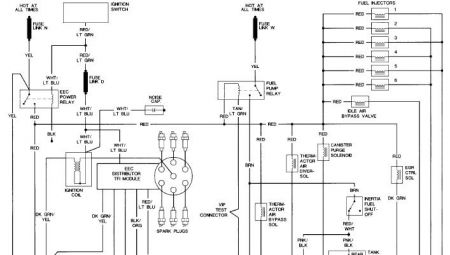

1989 Ford Truck need diagram for ford 302
SMRM7676
Electrical problem
1989 Ford Truck 6 cyl
i'm getting spark to the injecters but they won't shoot out fuel
Nov 7, 2009 at 4:12 PM
JDL
  • 16,098 POSTS
Engine cranking, do you have spark at the plugs? Engine cranking, you have voltage to injectors but, no ground pulse? The computer grounds the injector circuit. Maybe the computer doesn't see an rpm signal?
https://images.2carpros.com/forum/automotive_pictures/170934_89_ford_injectors_1.jpg
The info I looked at was F-series 6 cylinder. The autozone site has free wiring diagrams, you have to register, but, it is free. Once you register click on repair info, I believe the wiring diagrams are under the chassis link.
