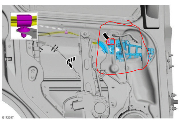

If you have the door panel off, are you able to access the exterior handle release cable? See pic i. If the door is unlocked, you should be able to pull on that cable to release the door latch. See pic 1

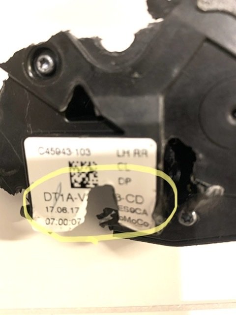

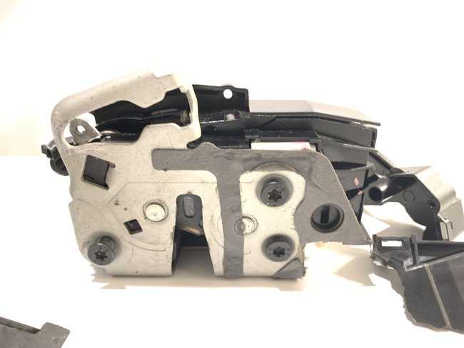

Thanks much for taking the time to post a possible remedy. Unfortunately, I had a mechanic break I believe the actuator? He said due to the child safety lock mechanism, that was the only way to get the door open? He was reasonable.
He said we need to re order the door lock actuator assembly. Something like this maybe? https://parts.winnerfordofdover.com/oem-parts/ford-latch-assembly-dt1z61264a27aq
Here’s the mess uhgg. Again appreciate your input.

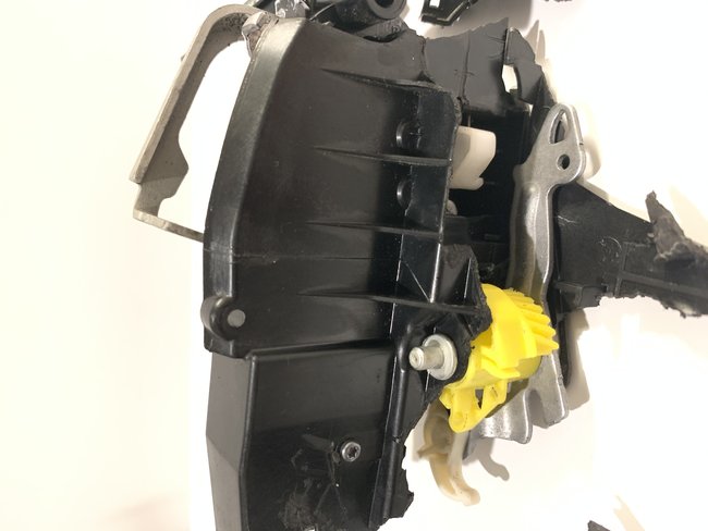

More pics in the event this happens to anyone else.

Pictures.

Well, I'm glad you got it open, but wow!!! It should have opened by actuating the outside door cable. Did he try that or was there a reason it was done this way?
