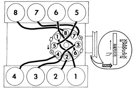

No spark to plugs need to locate #1 cylinder and get correct firing order?

this vehicle had MANY different engines to choose from...which engine size are you working on? 5.0L, 5.8L , etc...?

1974 Ford Torino 460 7.5l engine

https://images.2carpros.com/forum/automotive_pictures/261618_Noname_2265.jpg
