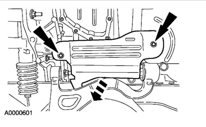

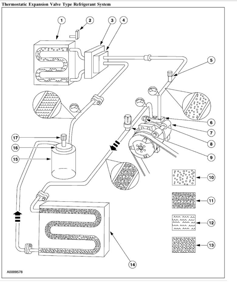

where is the air conditioning charge port (low pressure)?
Apr 7, 2010 at 1:33 PM
  • 55,433 POSTS
The low side port is on the larger ac hose that goes from the firewall to the back of the compressor. Here are some guides and diagram (below) that will help you get the job done. This video will show you how to find it with diagrams below.
