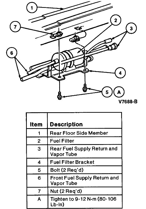

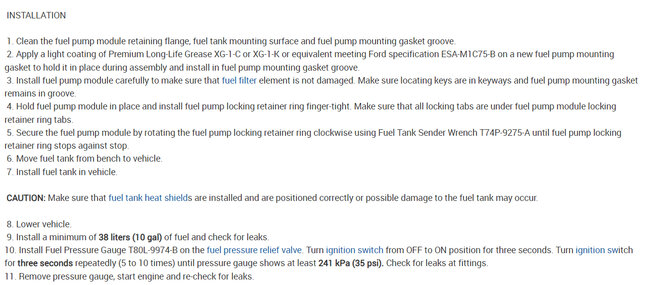

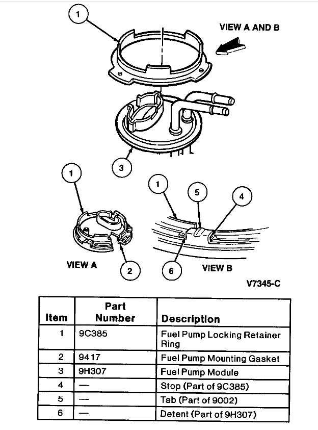

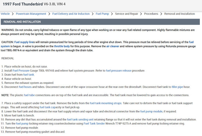

I have seen the fuel pump cause this problem, I would swap it out to help fix it, here is the location of the pump and I would change the fuel filter as well. Check out the images (below). Let us know how it goes
