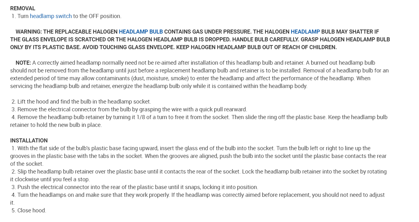

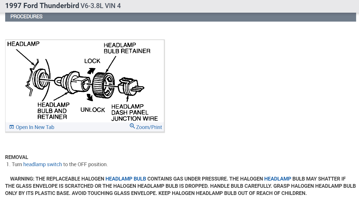

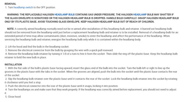

how do you replace the headlamp assy?on a 97 ford thunderbird
Feb 8, 2008 at 1:05 AM
MERLIN2021
  • 17,250 POSTS
I Think you should see 2 or 3 black locking tabs at each light, pull them straight up and out, then assy pulls right out. Here are the instructions for how the job is done in the images below.
