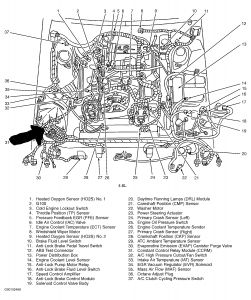

I have looked everywhere for this thing and can not find it please help if you can send me a emailed pic of where it is on the car. I have asked the dealer and still haven found it. Ive been told by the radiator on passenger side. Ive been told mounted on the wheel weld. I have looked in the manuals but they only show it for a v6 and 5.0. Can someone please tell me exactly where the ignition control module is for a v8 1997 ford Thunderbird.

The CCRM (constant control relay module) is located Right front of engine compartment on upper radiator support .. Constant Control Relay Module (CCRM) (4.6L).....On right side of upper radiator support. See Fig. 3 .
https://images.2carpros.com/forum/automotive_pictures/266999_ccrm_1.jpg

He asked about the ICM and got info on CCRM?
Nov 22, 2025 at 3:01 AM
  • 55,421 POSTS
LOL yep, the expert got a little mixed up on that one. There is no ICM, (ignition control module) this is incorporated into the PCM. Let us know if you need anything else.
