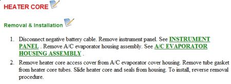

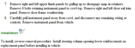

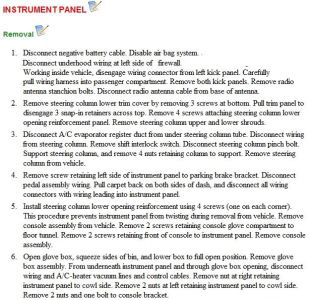

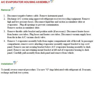

How do I replace the heater core on a 96 bird?

Sux huhm you have to pull the dash. Be careful with the grommet or you'll be erpeating this again soon
