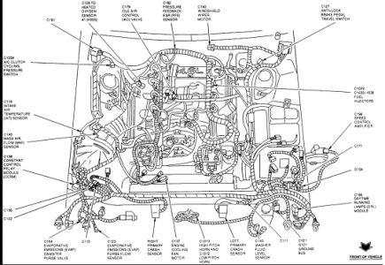

where is the fuel pump relay located on a 1996 ford thunderbird. I am ahving trouble finding it in the manual.

1996 Ford Thunderbird V8-281 4.6L SOHC Engine View
The Constant Control Relay Module (CCRM) is in the right hand front of engine compartment, mounted to upper radiator support.
