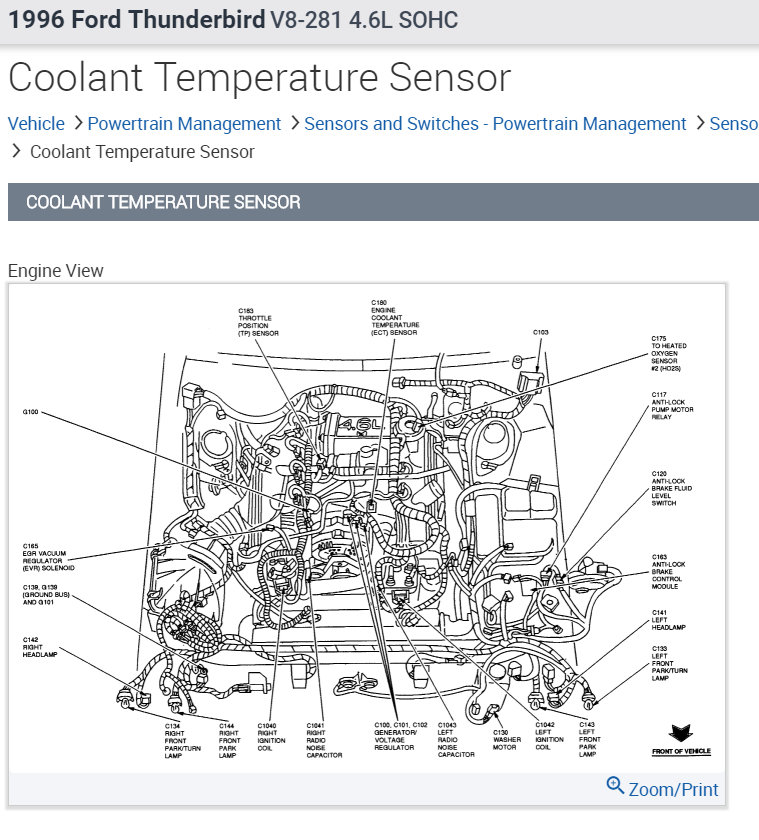

My cooling fan on my 96 T-Bird with a 4.6 is not working. I have replaced the thermostat and the temp sensor with no luck. I find that when I disconnect the cable connected to the temp sensor, the fan will work so it is not the fan itself. My temp gauge is running above normal and I have had a slight loss in coolant but no visible leaks. Any ideas?

This happens when the head gasket blows or the engine coolant temperature sensor is not working right. Here are two guides to help us see whats going on also the location of the temperature sensor.
and
https://www.2carpros.com/articles/coolant-temperature-sensor-cts-replacement
Check out the diagrams (Below). Please run some tests and get back to us.

Thank you galletta61 for your reply. I had checked the engine fan fuse in the high current fuse box and it is good. Then I did the head gasket test and it tested positive so its off to the shop for a $900.00 repair :( thanks for your help though.
