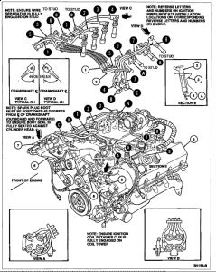

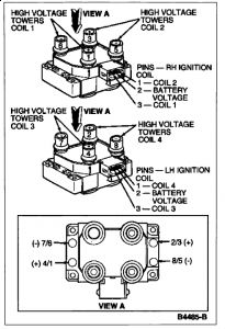

does anyone have any idea where I can find a firing order diagram? We know the sequence but can't seem to get it right
Monday, January 11th, 2010 AT 4:10 PM
MECHANIC
75,992 POSTS
1 Ignition Wire Separator
2 Ignition Wire (8 Req'd)
3 Cylinder Head
4 Spark Plug (8 Req'd)
5 LH Ignition Coil
6 Radio Ignition Interference Capacitor (2 Req'd)
7 RH Ignition Coil
A Tighten to 9-20 N-m (7-15 Lb-Ft)
Firing Order 1-3-7-2-6-5-4-8
